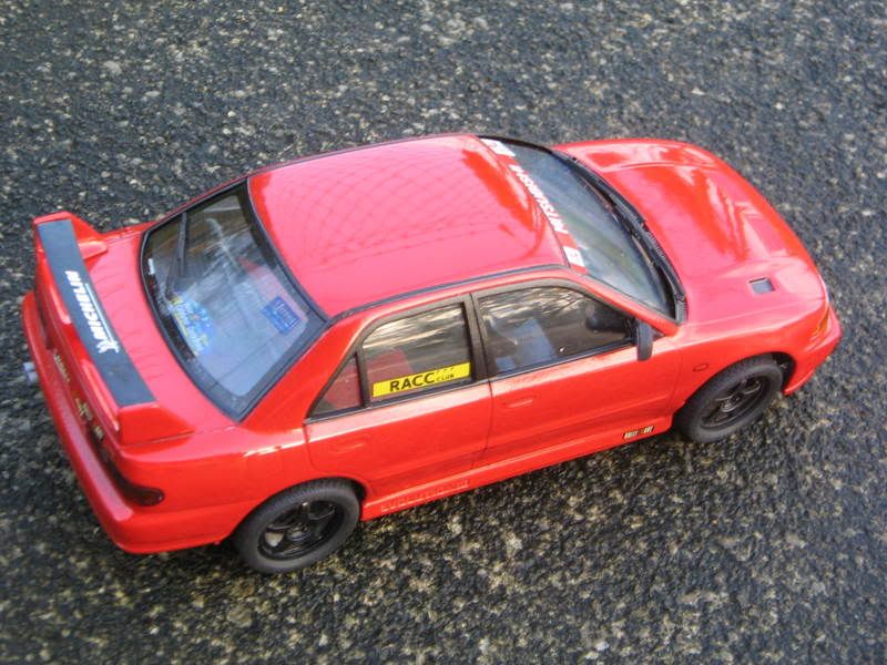

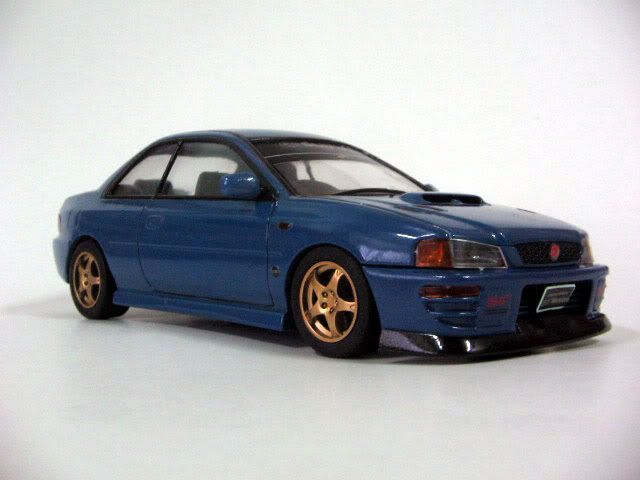

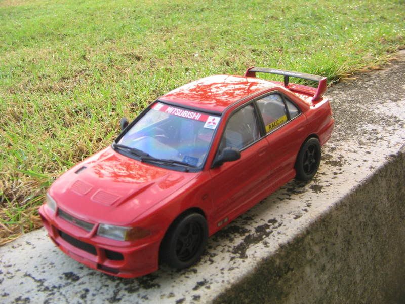

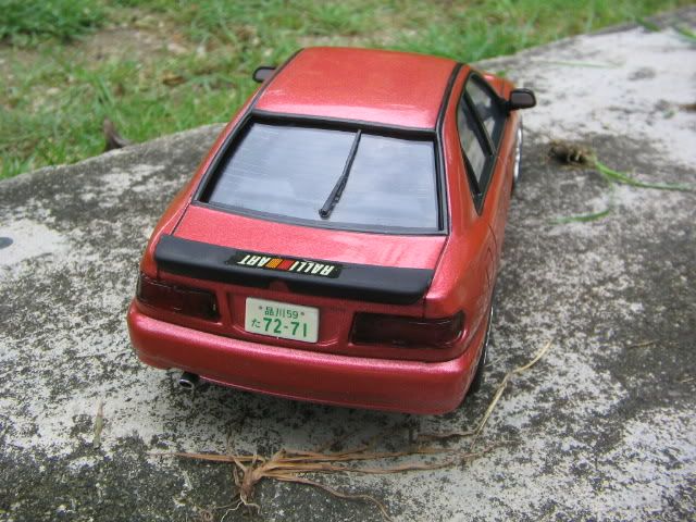

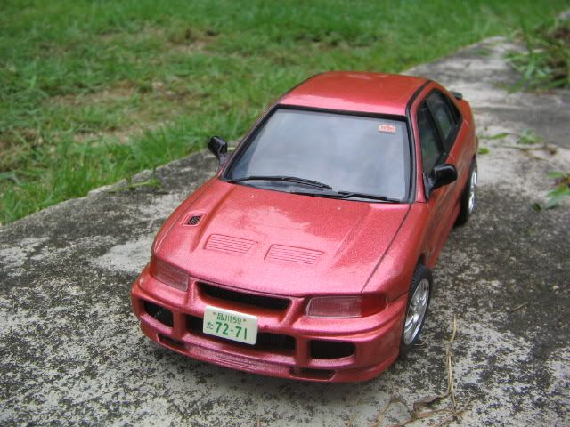

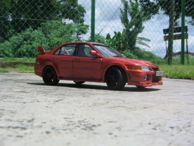

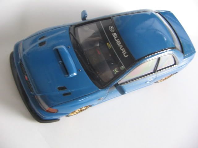

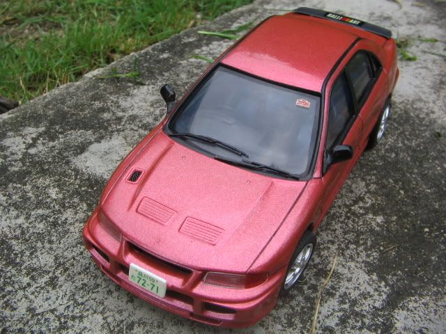

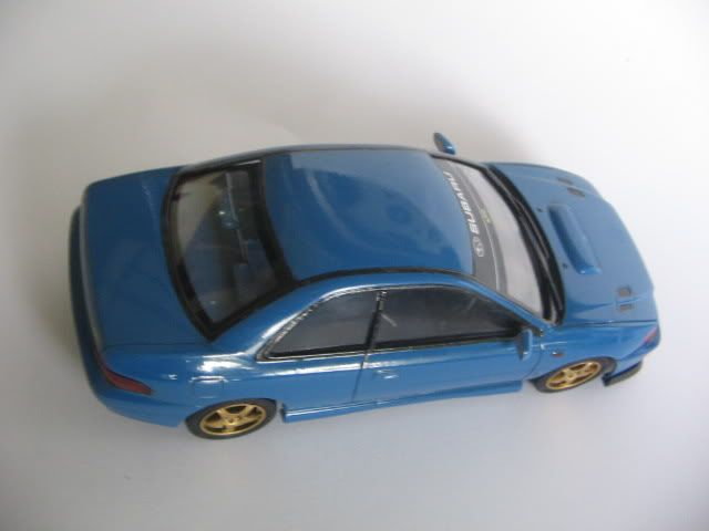

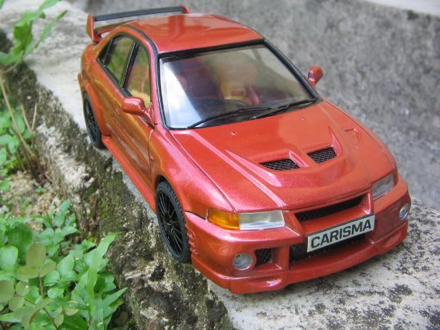

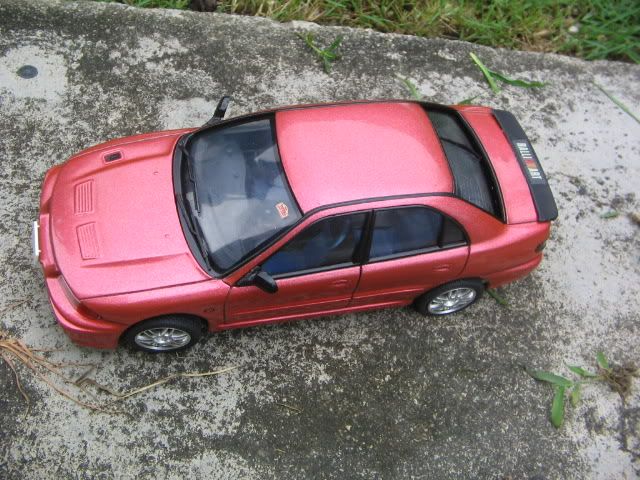

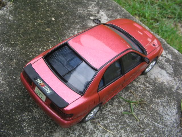

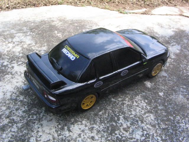

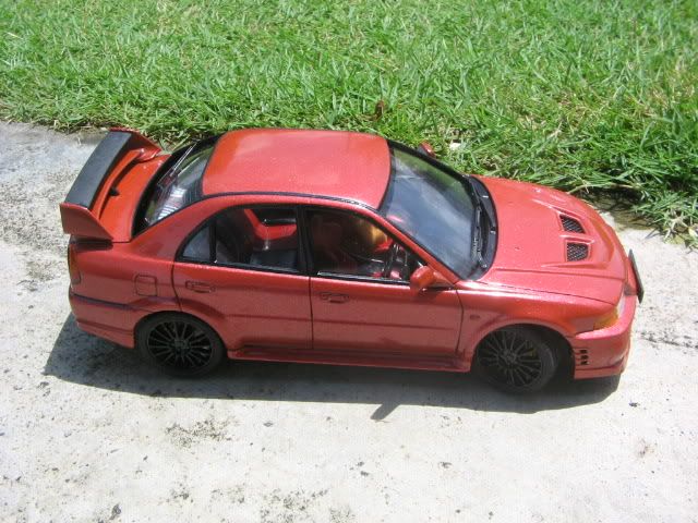

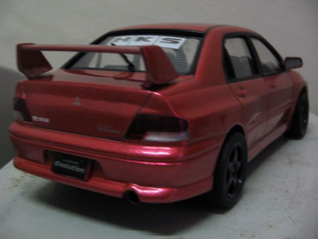

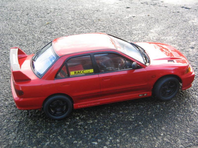

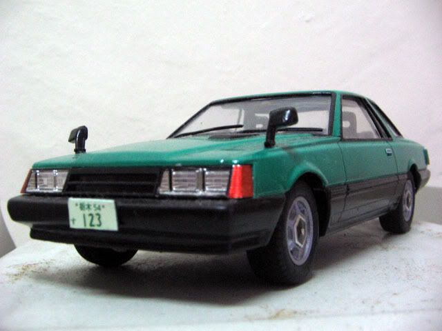

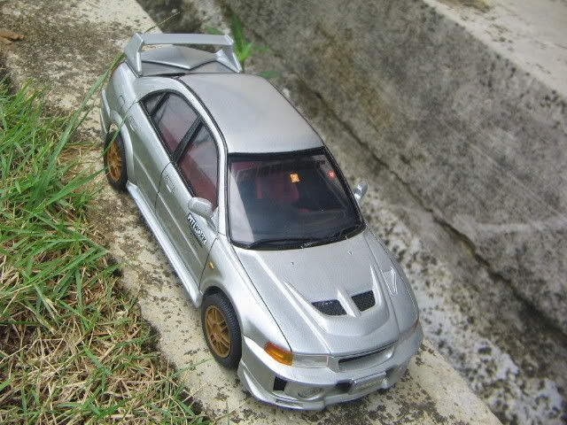

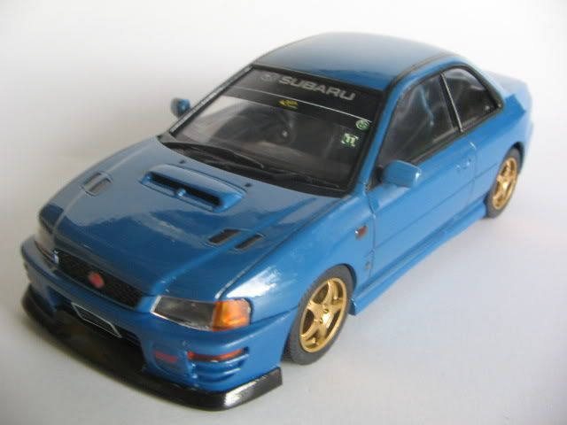

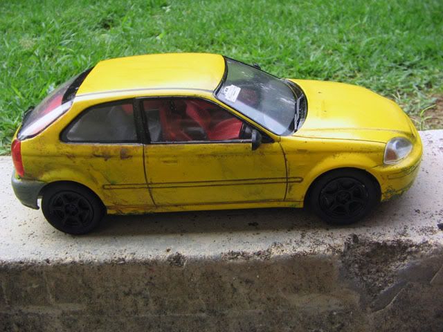

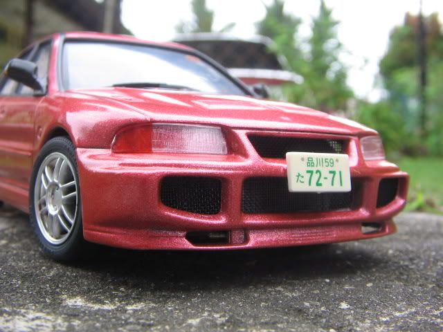

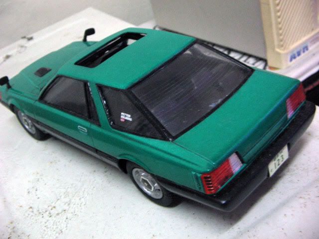

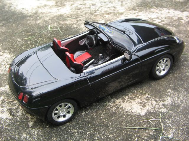

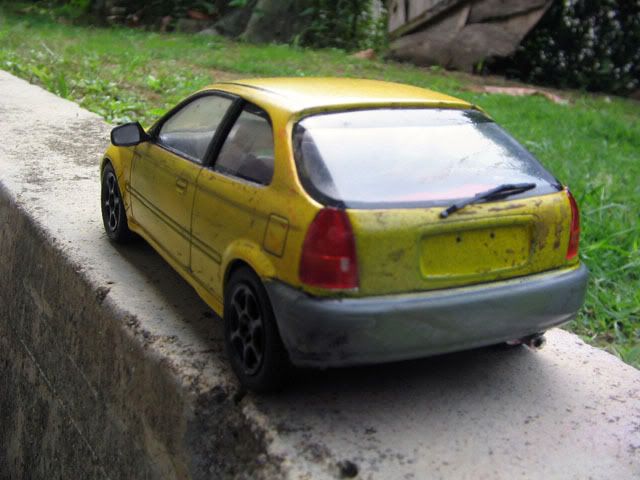

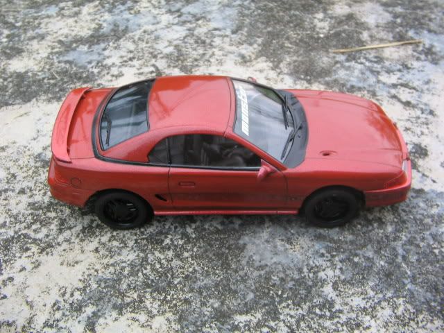

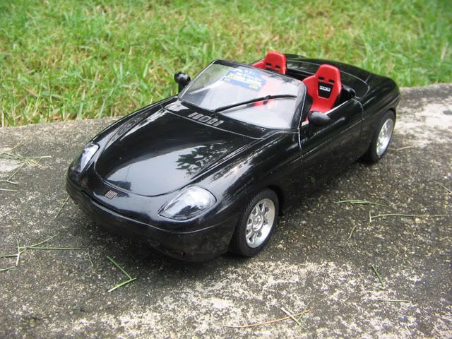

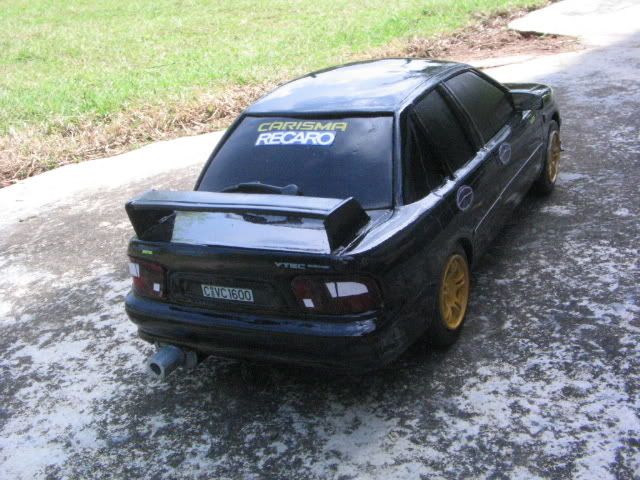

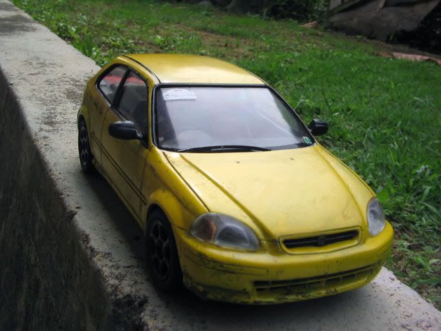

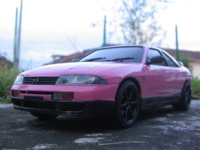

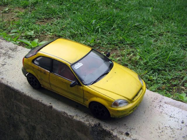

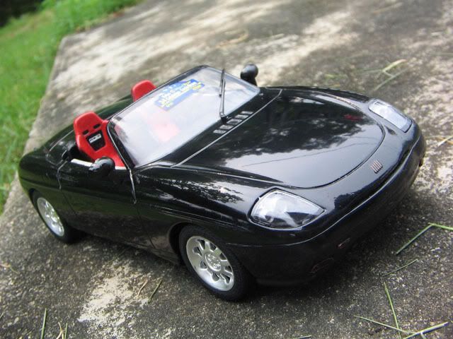

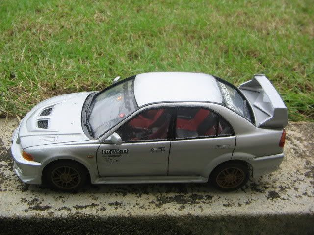

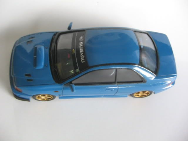

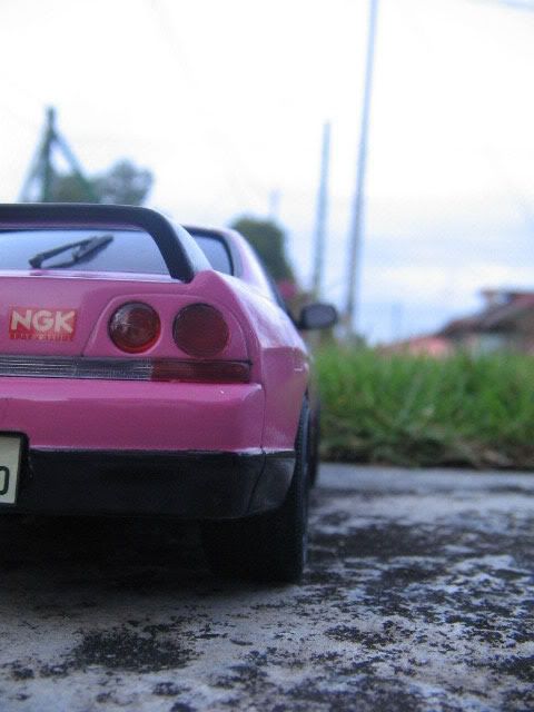

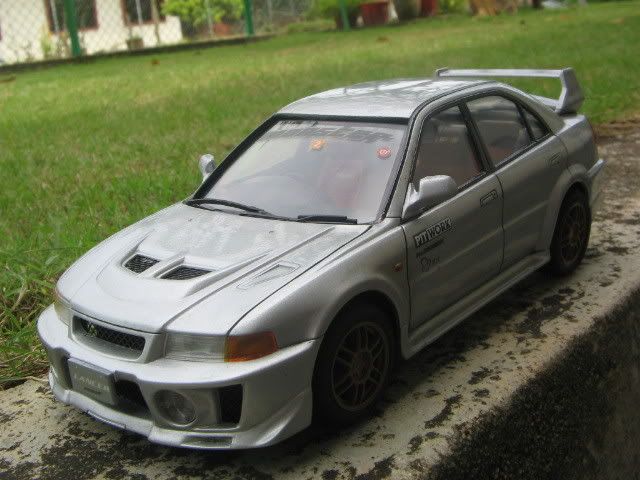

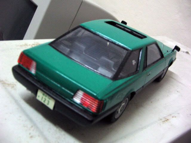

I build models for about a year and i love this hobby very much..
Here are some photos of the models i build...
Let the photos do the talking ok?

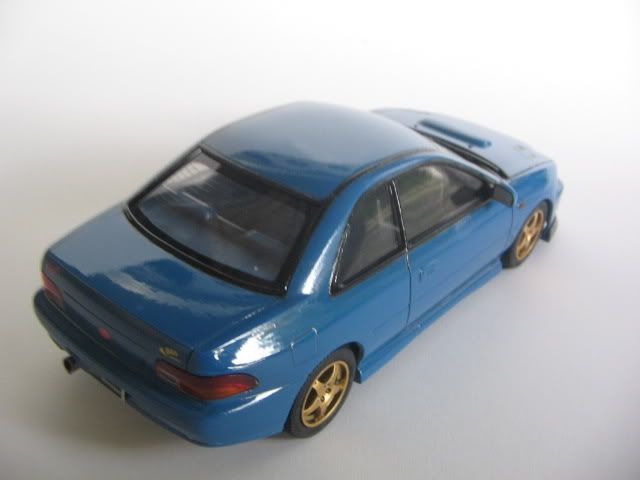

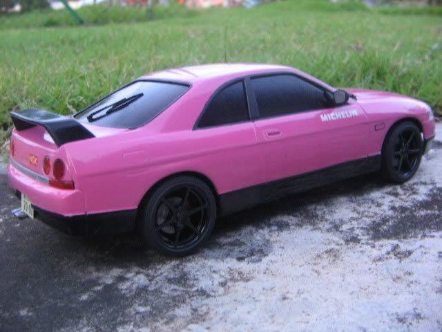

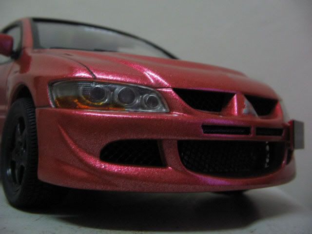

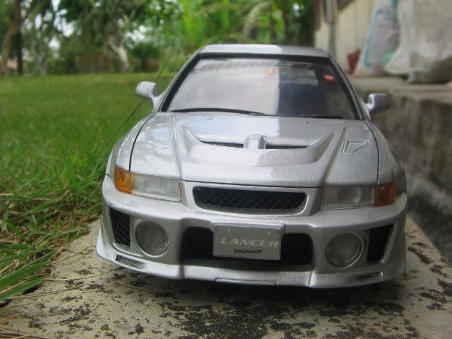

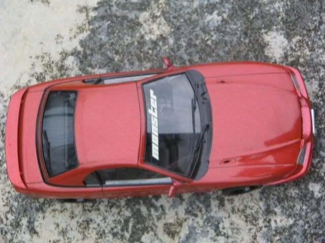

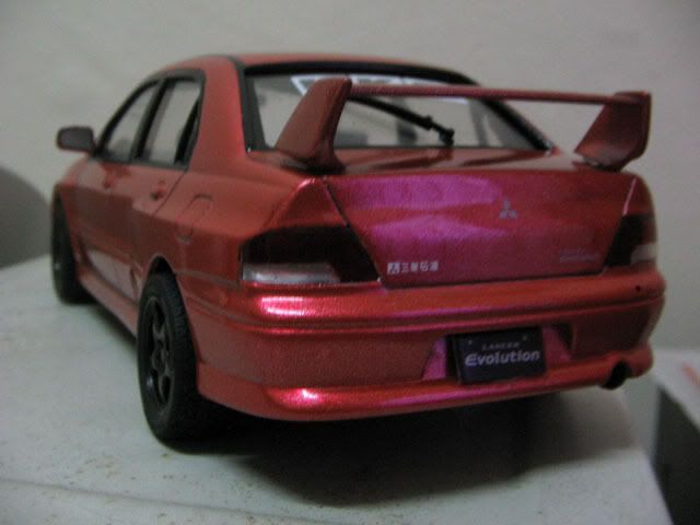

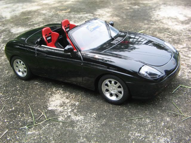

Fiat Barchetta
Mitsubishi Lancer Evolution VIII GSR
Nissan Leopard TRX Turbo

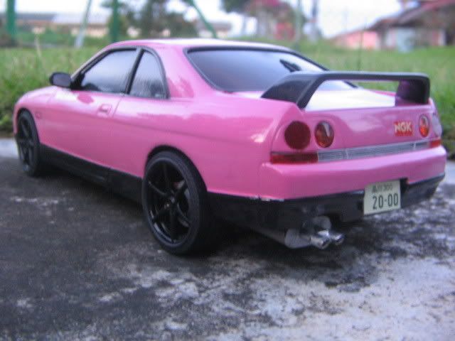

Nissan Skyline GTS R33

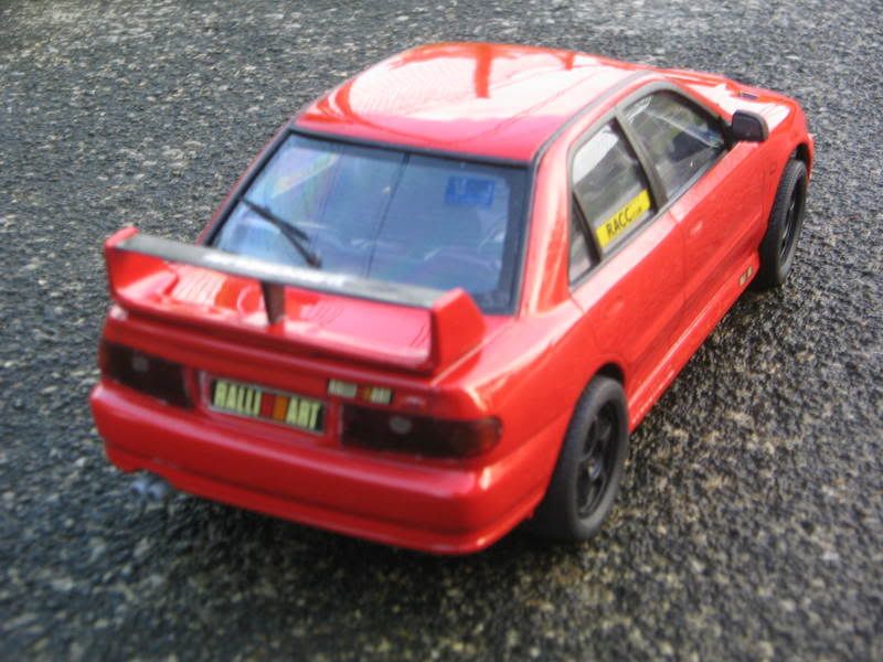

Mitsubishi Lancer Evolution III Fujimi
Mitsubishi Lancer Evolution III Hasegawa

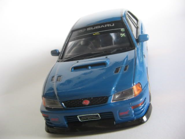

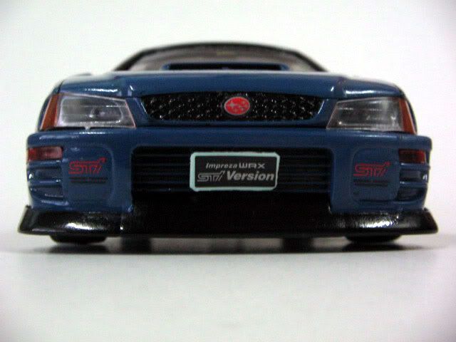

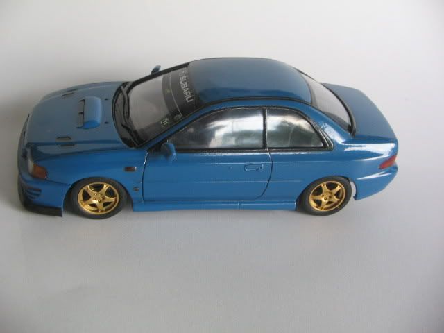

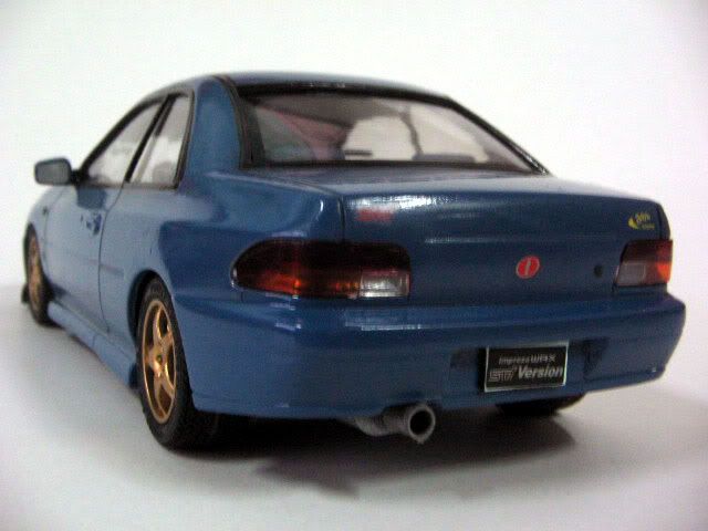

Subaru Imprezza Type R WRX

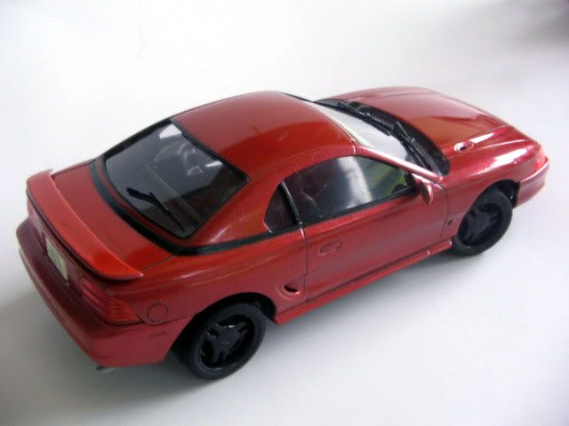

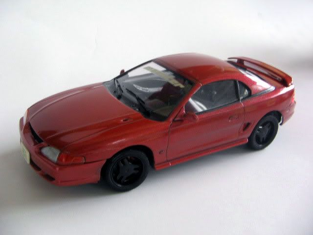

Ford Mustang

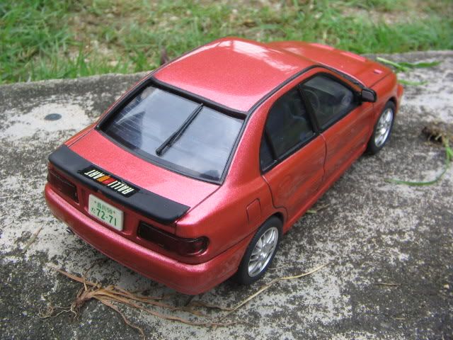

Mitsubishi Lancer Evolution VI Carisma GT

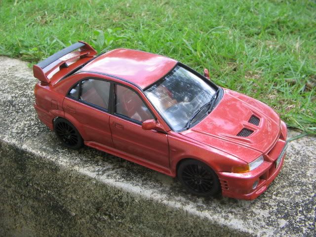

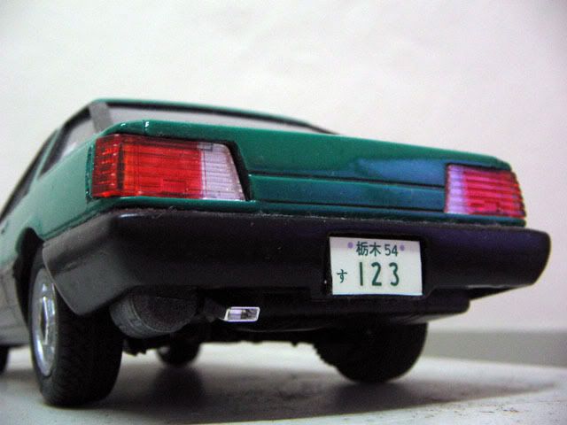

bro selipejepon, i forgot to mention, if u wan to opt for any fujimi rim, remember to go for at least 17" and above to make the car look nice. As you can see, wat me and bro JayDM discussed, the rim sizes are off. I don't really have a closer shot of the ADVAN RG but those rims are just RM30plus so we cant really expect much ;) The rims still needs some detailing like for example the lock nuts, wheel cap hole, and like TCII rim that they painted bronze on the whole without the silver middle section. ADVAN RG doesnt look much like the real thing most probably because of it's size and it's much thicker on the 6 spoke (as in depth, not width) Good luck ;)

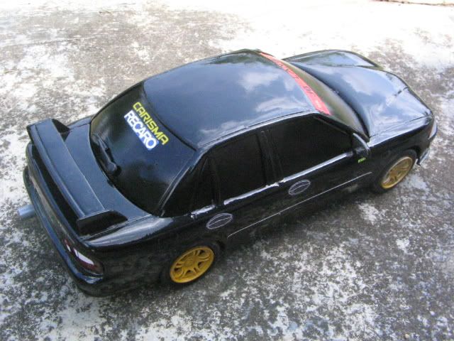

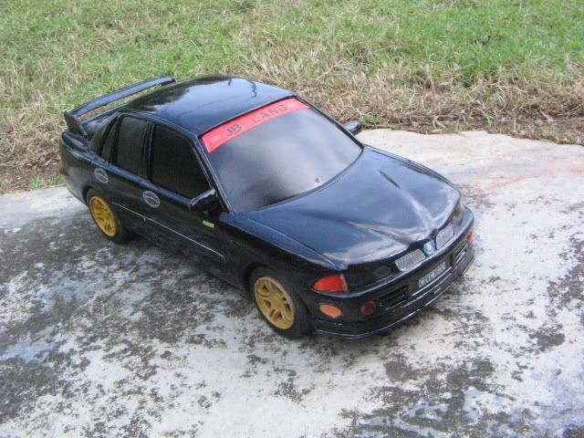

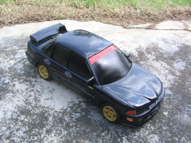

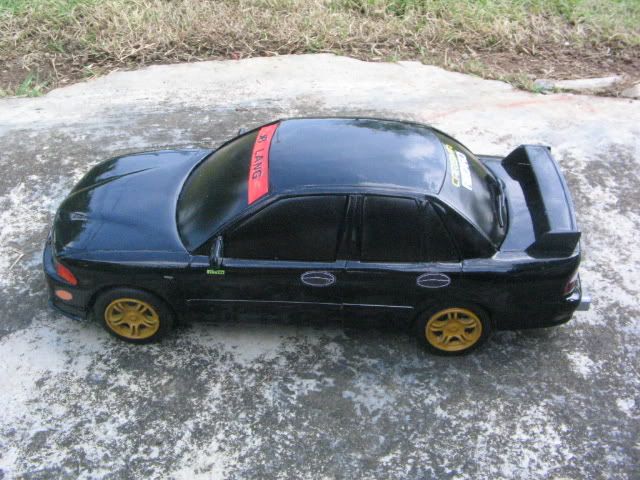

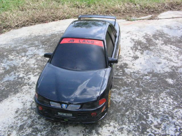

here's another 'model' that i modified from a static coin box given by public bank ages ago
