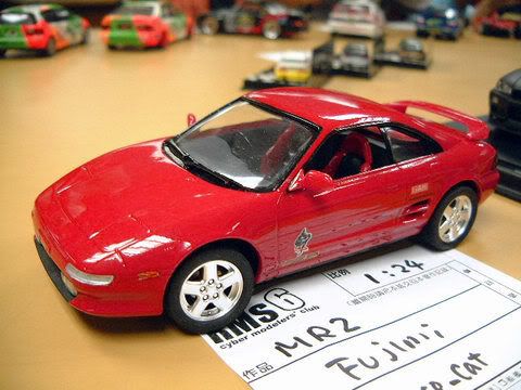

I am looking for a MR2 SW20 (as i drive one myself, so i tot it would be a good project to start with...)
Anyone know where I can get one?! I know there's an Initial D one out there somewhere...
Hope you guys can help me out...
Thanks
Here's pic i found on the net. It's a Fujimi...

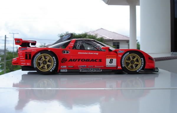

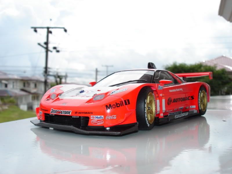

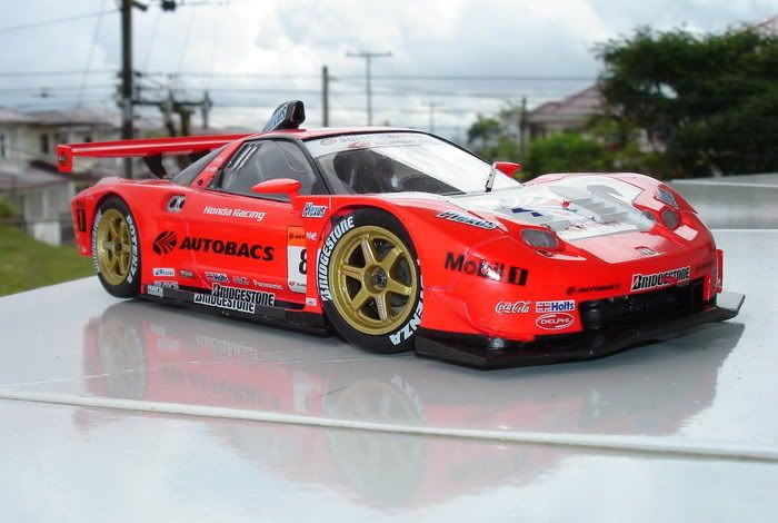

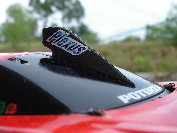

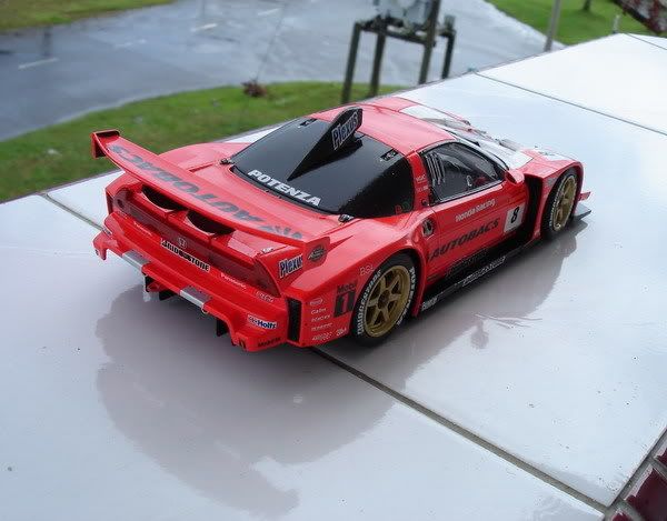

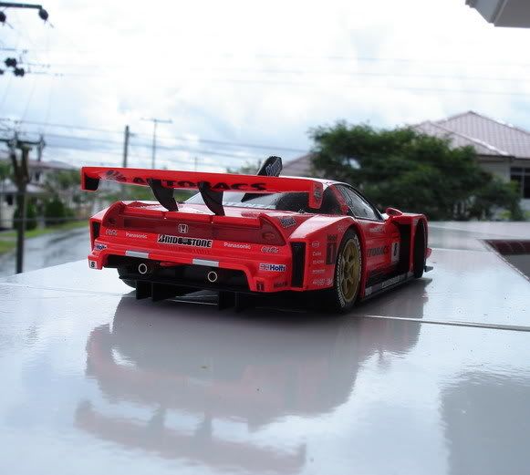

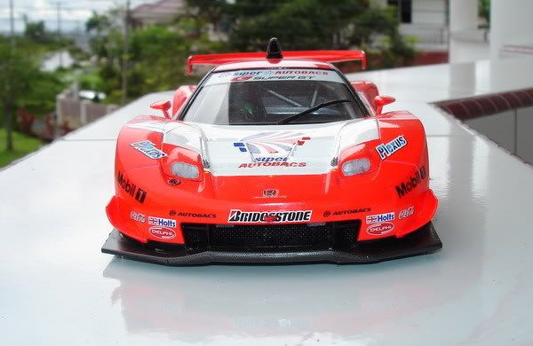

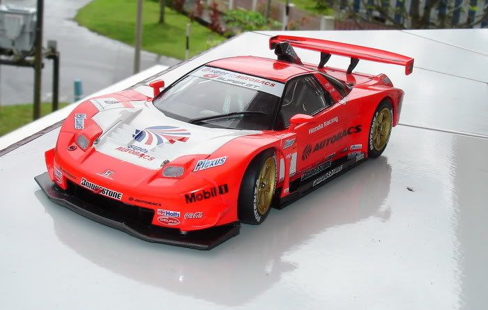

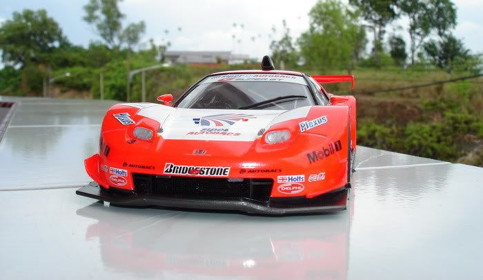

My ARTA NSX has finally been completed. I'm tired of waiting for the diagonal weave pattern carbon fibre decal so i just use the normal weave i got to complete it. here's it : )
I love the photoetched catch pins >_
