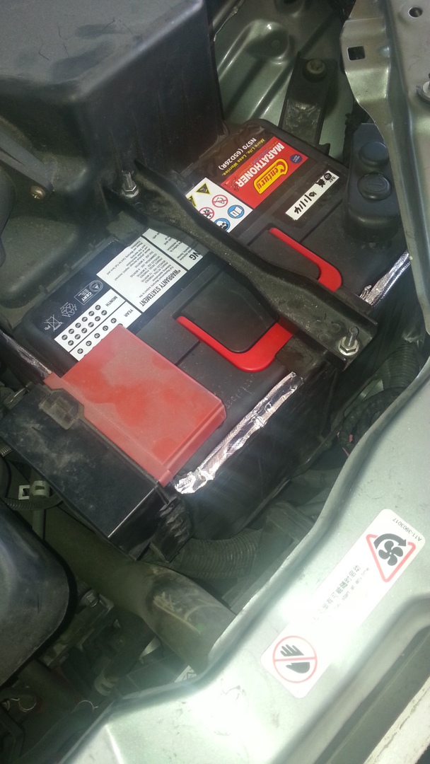

I do that for all my batteries that are in the engine bay. Wrap in superlon and reflective material. Keeps the battery relatively cooler and seems to last longer. The plastic cover alone isn't enough. Wanna wrap go extreme! Hehehe. Superlon + alu tape.

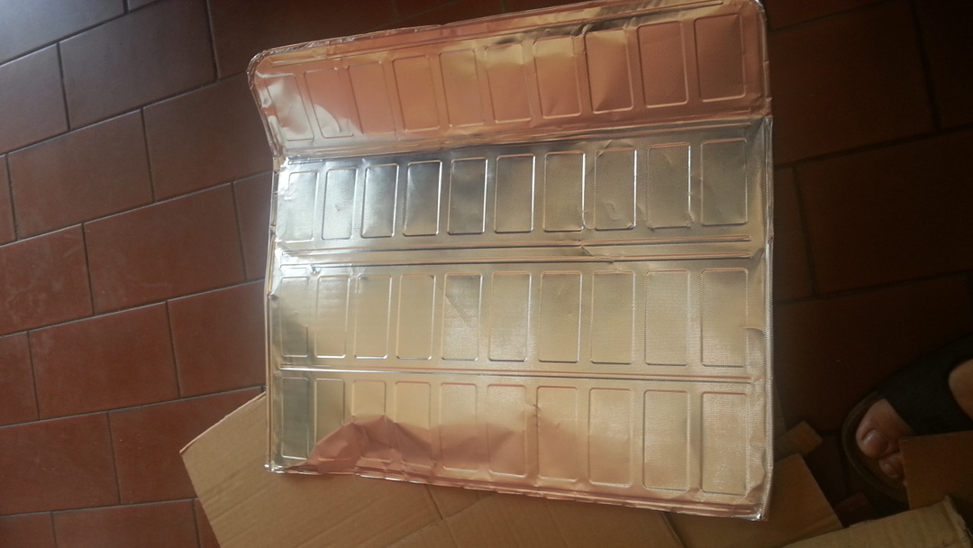

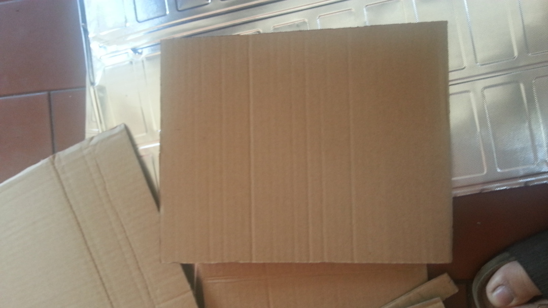

What I did for mine is to block the air flow from the radiator fan using the aluminum sheet bought from Daiso. These sheets are meant for use in the kitchen cook stove to block oil splattering etc. Measure and cut to size wrapping a cardboard inside then fitted to block hot air hitting the battery. So far looks like proven as my Chery battery lasted 3 and a half years. Hyundai one 3 years 3 months and VR one already pass 2 years. Those days before heat shield mod max around 2 years only.

Yeah I know those aluminum sheets, I had used once before for the kitchen! I'll try make the shield for my batteries later.

Also used many brands before, all almost the same service life, but lately with heat shield they last much longer.....:driver:
