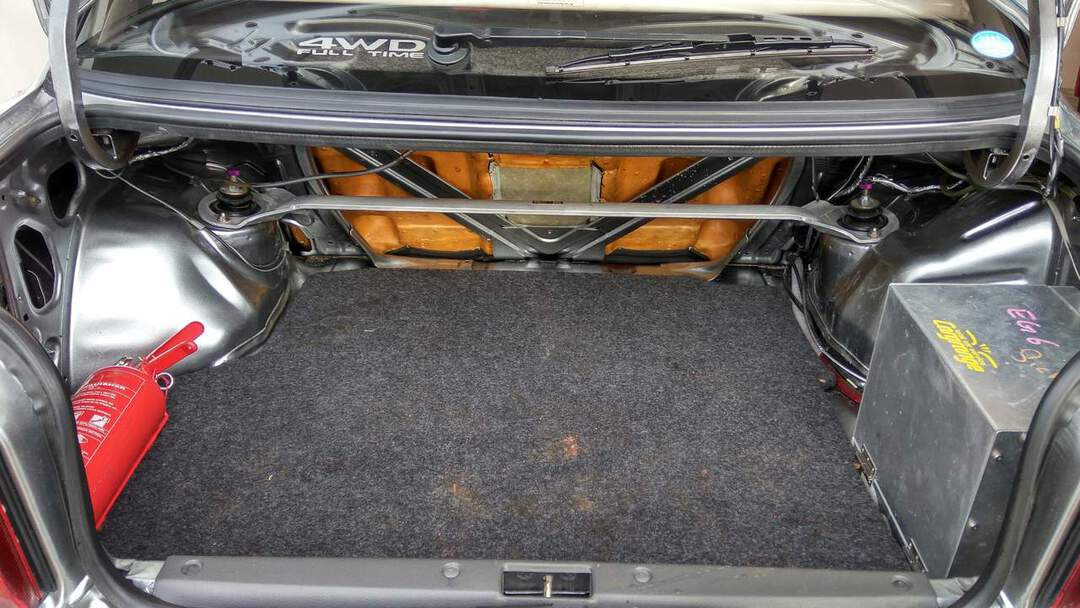

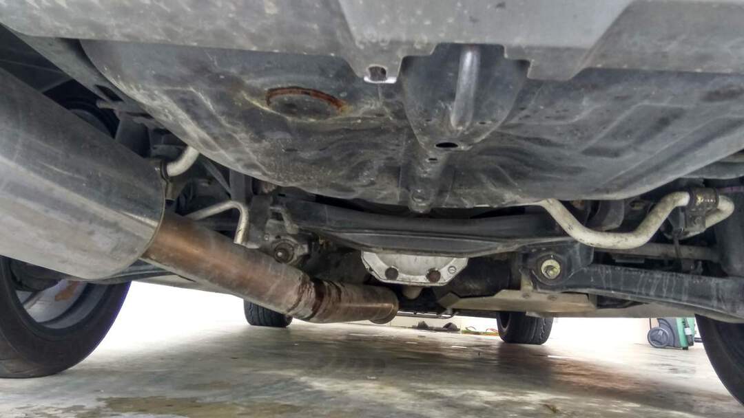

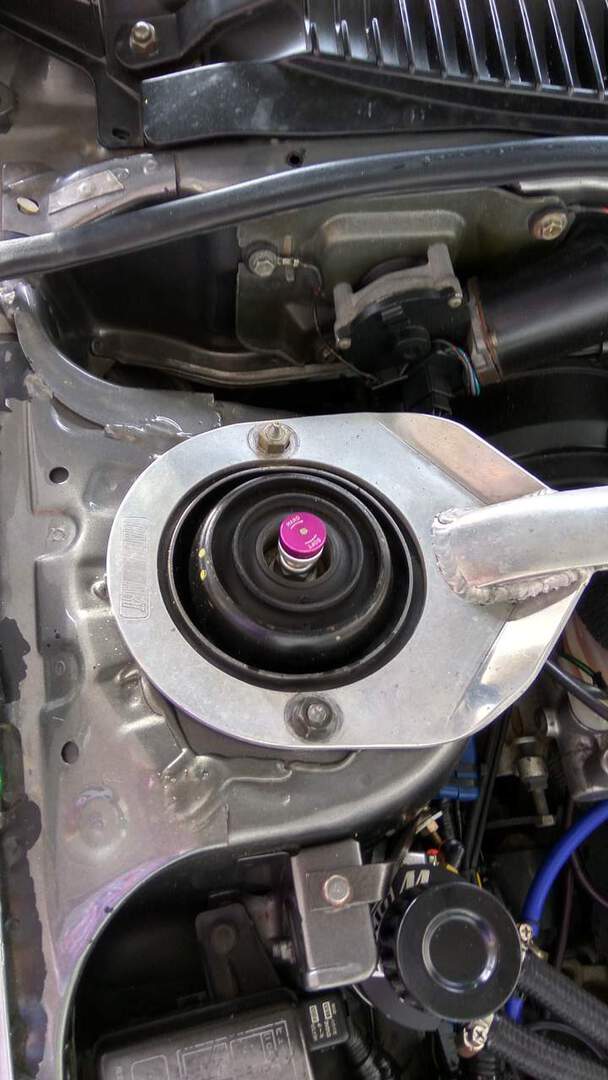

Using evo 2 with 1 way lsd gearbox and stock awd system with rear oem 1.5 way mechanical lsd, the handling quite nice already, add on are the d2 adjustable, ralliart front and rear strut bars, UR fenders, front lower arm, room, rear upper and rear sway bars....

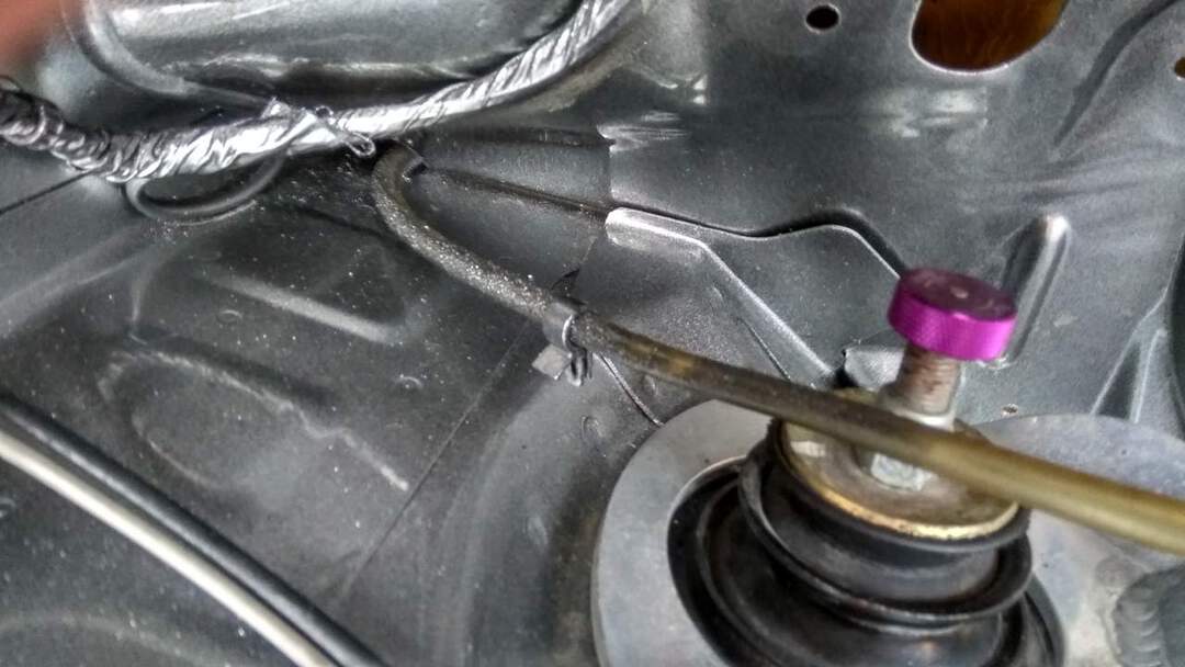

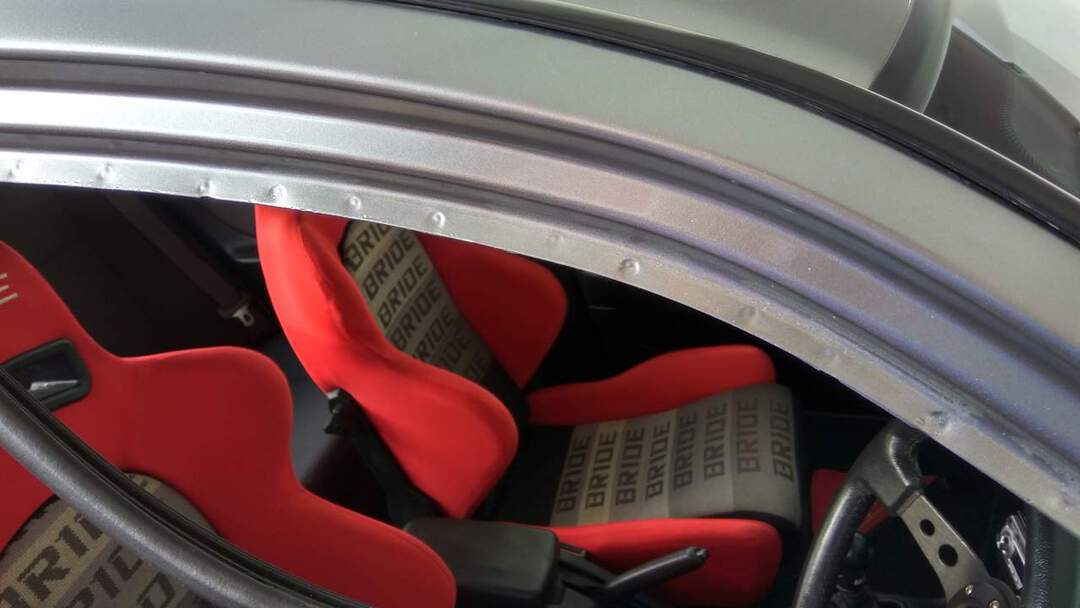

The pictures also showed differences of evo body, with extra reinforcement at front and rear strut pillars, the significant rear V bars, and also my friend did told me abt the closer spot welding, i not sure is right or not but i will still take pictures for your guys to justify
I really appreciate this post, Peterj. Because of your highlight regarding the extra reinforcement welding on front strut tower, I can use your picture as a benchmark to identify whether cars on sale are really Lancer Evolution or just normal Lancer CB. I actually din't know this until you posted it. You are the real Evo sifu.![]()
There are always ways to convert nornal lancer to evo, chg body direct or weld them self, but if u see real evo with out those chassis reinforcement, it is not
