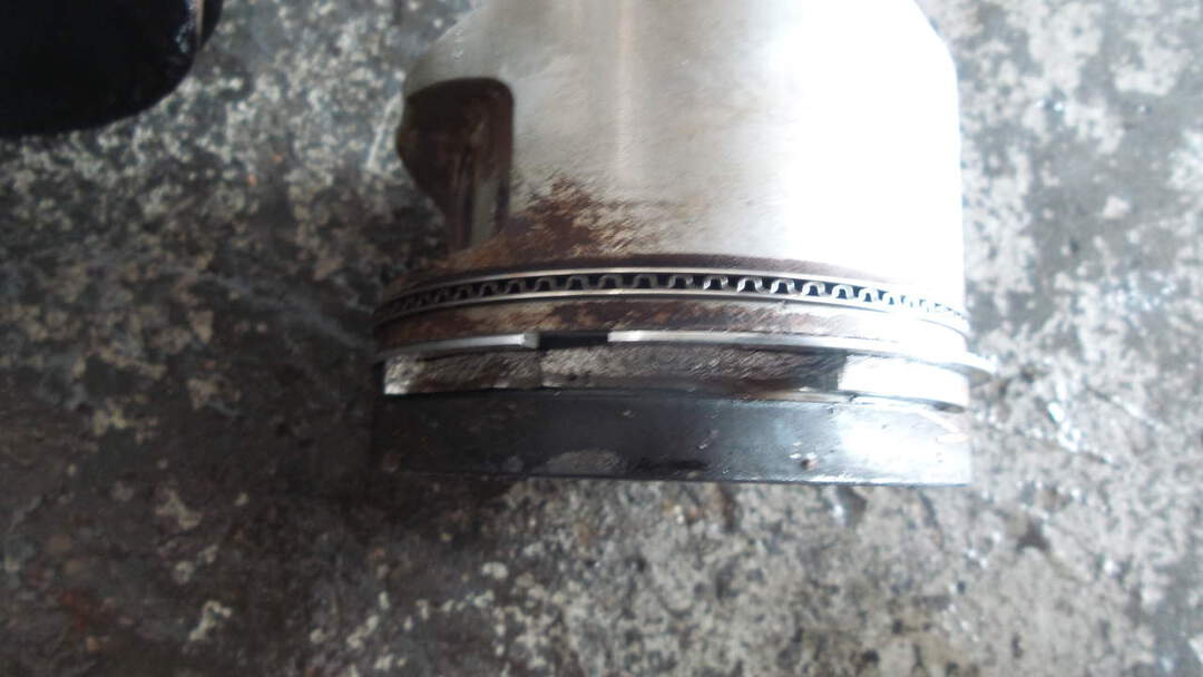

everything look fine and seems fine to use since the block seems smooth , piston all ok.. but God decided to give me challenges:rolleyes:, starting with a joke while we try to get the ring gap for the new rings :banghead: when we push down the 1st ring with my piston, and measure, seems like 2 of the sleeves, 1st and 2nd have higher ring gap then 3rd and 4th and it is beyond the tolerance level (0.500mm if not wrong).. ok, i can tolerate that, at least i save my wallet up by staying stock internal and buy new rings that suits the "bigger" bore.... but the real challenge comes, when my mech try double check the ring gap and taking different piston to push the ring down, this shows up:banghead:
it happen to the 3rd piston, a cracked piston groove, damn how could it happen? i had been driving and boosting it (low boost 0.7bar:biggrin:) almost 1 year and nothing happen until i open the engine up to discover this shit:banghead: so frust, i only can accept it, maybe the ex ex owner done the damage and god protect me and make it shows up only when i open the engine, or maybe God says i alang alang susah susah open engine, want rebuilt then do a real rebuilt:rolleyes:...ok, then i went from frust to waiting status, waiting my sets of forgies to arrive:biggrin:, however the courier guy didn't show themself today so no pic ture of it yet:thefinger:, hope fully tomorow got:driver:....but in the mean while, my rebuilt turbo from Speedspin turbo already arrive, this is 2nd time and they are still not making me disappointed,porting jobs etc looks real nice and shiny,good workmanship turbo that make me cant wait to boost it, this make me recover from the piston crack incident and pain of wallet burst for buying forgies:nurse:.. i recommend it here to all our forumer,here are the FB link if u want some advice on turbo:listen:, they are nice and friendly guy https://www.facebook.com/speedspinturbo?fref=ts
