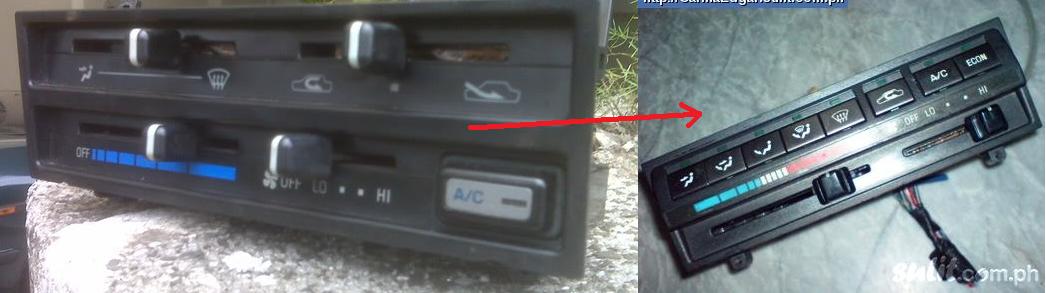

Can toyota se with normal aircond panel swapped with digital aircond panel(from gt version)?
Need to change anything or plug n play?

Bro Lanz, yes you can swap the analog one with a digital one. My original panel looks like yours with exception of the A/C button. I have swapped in the digital panel during my engine transplant. Works well...but I notice that for mine, the panel cannot fit properly. When I push the panel (e.g. switching the air cond from LO to the next speed) the right side of the panel tends to sink in. I had to pull it back out slightly. But that one might just be a bad installation from my workshop.
Btw, do you know where I can get the digital panel? My fan speed control (speed 1) rosak haha...Now i am always on speed 2

I think its not plug n play for my A/C system because my blower control is manual type which is different from digital control system.Maybe it fit ur car perfectly because of the engine transplant which i beleive has digital A/C system.Manual control have cables and digital control have wires instead of cables to control the A/C system.

Ah bro Lanz, perhaps you are right...I apologize for the inaccurate info...my bad...:afraid:

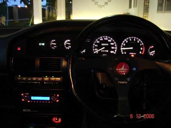

attachment.php
Saw this on google.
Looks decent n damn nice.
The meter panel looks bright.
My short meter were very dim.
I got one long meter but hvnt fixed into my car yet.
How to get that bright?

i guess u need to use brighter bulbs? and clean the inner part of the meter if its possible.. just an idea..
i replaced one of my bulbs recently, the one at the right most corner, the fuel gauge.. It is not bright at all, can barely see it at night!
just gonna let it be, till i REALLY need to change bulbs again, then i would opt for a brighter one..
p/s: the one in your pic, the meter is WHITE? :hmmmm: nice!
