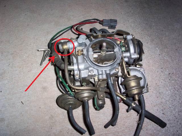

I finally got the engine started after tried few try and error.It was the carb which gave prob.I try to unscrew the nut circled in the picture below and crank the engine,after some petrol flow out from there i fix the screw back.I try to start and the engine can be started.I was happy and thought the problem was over.Unable took the car to mechanic as it was almost 7pm and the shop was closed.I drove the car next day to work as it was raining.It was ok for 2 days and today the problem started again.The parking at my workplace is a bit tilted downward(like a ramp).So the front part of the car was tilted downward.I dont understand what is the rootcause for this problem.Do any dirt clogged inside the carb?Saw some black oil coming from the carb body(looks like leaking).Unable to get the mechanic today as it was raining.Will try to push the car away from parking to a straight position and try to start tomoro.If fail had to tow the car.Basically i dont like my car to be towed.But it was a nice experience troubleshooting a carb.I learned new things.It makes a new interest to study and explore more abt carb troubleshooting.

good to know, but isn't that the PCV valve or something? that's where air and vapour from the crankcase goes into the combustion chamber to be burnt.. that could be your engine oil vapour accumulated over time, the one you said looks like leakage.. But i dunno how this could effect your engine from starting up?

Its from the fuel pump bro.The PCV hose is diff.This carb has too much piping especially for the vacuum.Hard to study.I wonder how the engineer design the carb:hmmmm:
