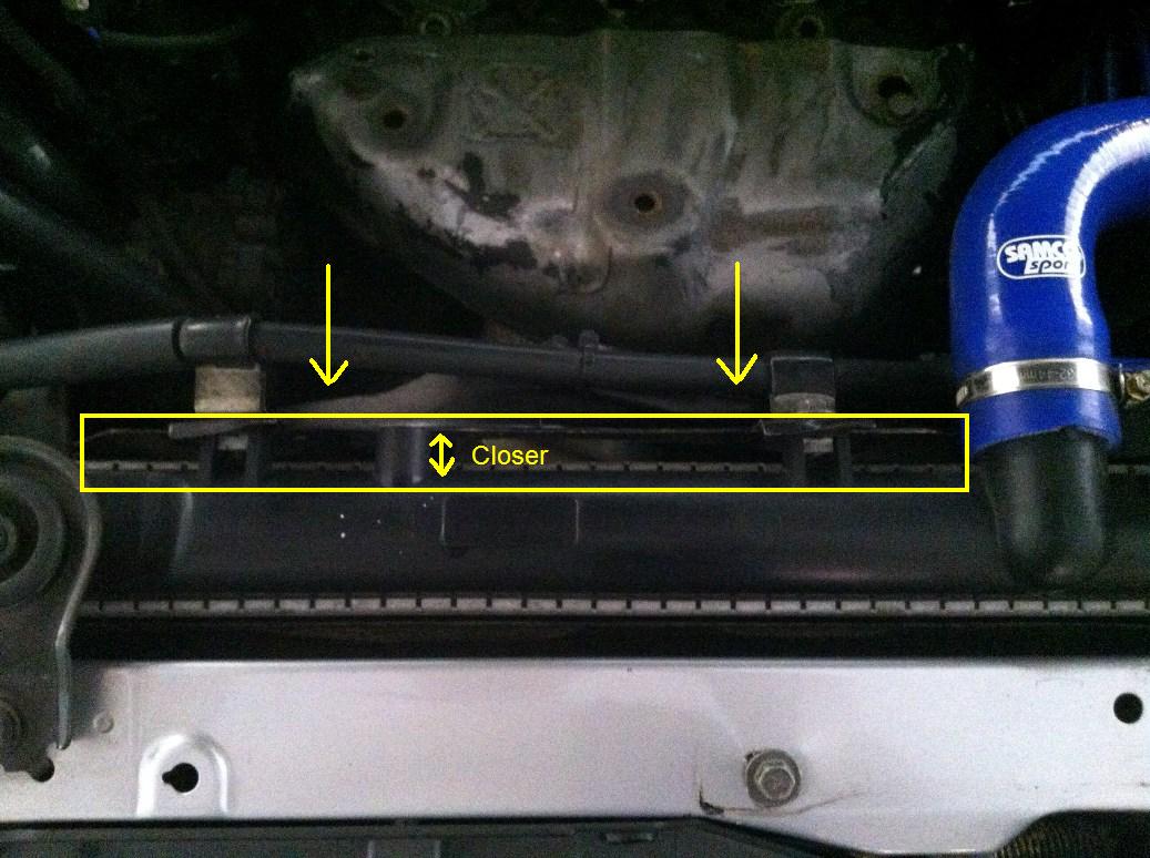

Question about the radiator fans, did you keep both original fans with just a minor modification to the one closest to the turbo? Do you know details of what Ah Wah does so everything fits?

I kept both fans original. The modification Ah Wah did was to cut the radiator motor mounting so that it's 'less thick' around the mounting & radiator contact. Highlighted in the box is what was modified.
attachment.php
