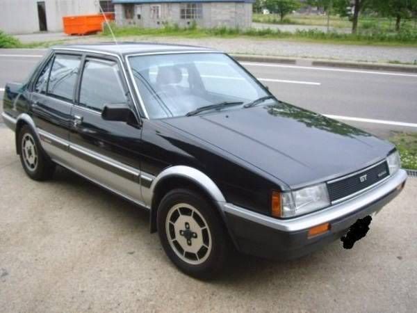

just sharing what ive found on the net...hopefully mine would look like this soon :biggrin:
apparantly theres also a earlier GT version that looks like our first generation LE :hmmmm:
wow nice color scheme in the 2nd picture. that will be my next repaint. thx for the pic. Black is so cool. :burnout:
nice bumper.... kanasai...... with lips summore aihhh......
bro AE80TypeD.... black is sooo COOL..... yet soooo HOTTT in Malaysia :p i'm thinking of red and black.... hahaha.... dunno what colour yet... next month i try and error and see how is the outcome....
