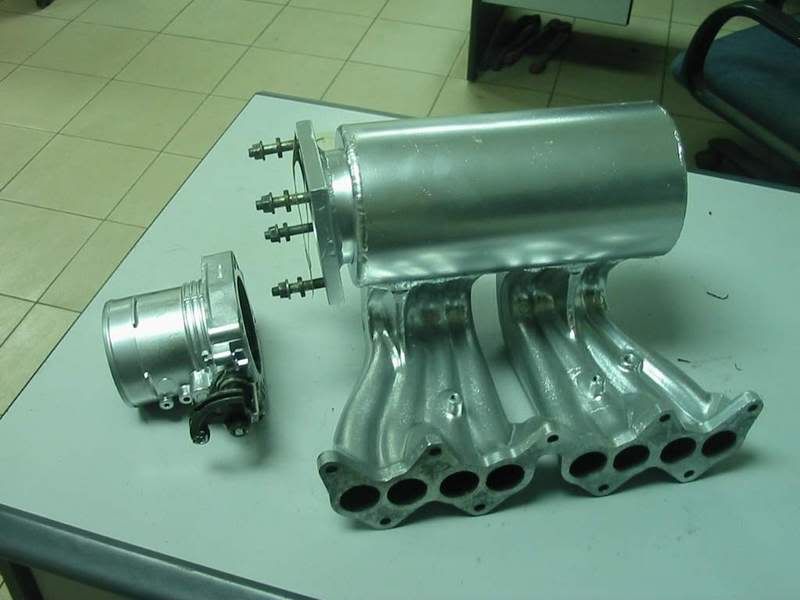

just share my Q45 90mm throttle with 5"x 10" large plenum intake pics.

his big throttle body look really sweet, if u put it into ur street or track car u will cry!! hahaha, u know how much rev, boost, and cam duration he running?

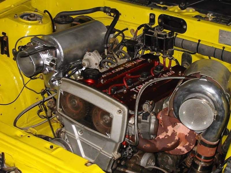

What you mean... the picture show the turbine so Big loh.... And also them using 7A block 1.8cc la....
You so early ah..... So, Did you nego with them about the muffler...........
only 1.8 engine can blow the big turbine easily ???? how the turbo lag...

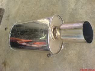

regard the muffler, the bro bought it rm350 from mun lee, used for 2 days only cos it is not suit for auto...the bro place this muffler at a shop and the selling price asked for rm300-400 ler, the bro still want to make untung....!!!
this muffler is not fully straight flow...dont want throw money to try whether quiet enough, fast flow enough...
