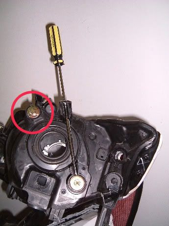

here:-
clockwise = Left. anti-clockwise = Right
http://kevinc.fivio.com/pics/5517/left-right.JPG
and here:-
clockwise = Up. anti-clockwise = Down
http://kevinc.fivio.com/pics/5517/up-down.JPG

kevinc said:
exclude of course...wif handle u'll get 4" only laa....kekeke
here:-
and here:-
bro, is it straight right into the hole?..... i tried look for it..i saw like nth 1 thru the hole.....u got bigger pic of the whole....aiseh damn susah oh ...
yup yup shove it all in
http://kevinc.fivio.com/pics/5517/DSCF0138.JPG

kevinc, wat if i screwed the red circle?..wats will it happen?...coz i tot its that 1...i link from top to down by open wheel arch...den saw that screww...tried to screw it...dunno whether got screw o not....

That is the horizontal adjustment screw.. at first i adjusted the wrong screw as well, pretty much screwed up my beam pattern >_
