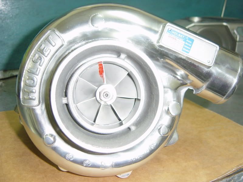

haha...i've posted bout Holset many years ago.. anyway..i've one piece to clear in stock..any interested takers ?
Holset HX45Pro (700hp)
wonder what rpm it will have full boost if i use 2.2l 4g63?:smokin:

hx35 nice for 1.8-2.0 very fast boost kick
hx40 nice for 2.0-2.4 very fast boost kick also actly , by 4k full boost, 65lb/min capable which means 650hp :P

just get a hx40pro bro ,
http://www.dsmtuners.com/forums/420a-turbo-conversion/310474-hx-52-installed-pics.html
im sure u also read the other dsm threads , just explore wht the other parts of world is seeing with
the holsets and borgwarners with bullseye's help
the hx40pro just simply kicks the GT35 up its ass , GT3582 is just about max 60lb/min max
see wht hx40pro is offering , with higher pressure ratio of cos , its shooting up to 80lb.min which says extra 200hp :P , further more holsets have strong catridge and repairable , and the spool up, just read on bro , the bigger holsets spool faster than the GT's with bullseye housing , holset & borgwarner are slowly growing bigger :D , i vote for Holsets & Borgwarners for sure.

the BEST part, compare GT Turbo price with Holsets , remember that holsets go thru hell on constant boost in diesel trucks n bus at very high pressure, wht la pressure we running 2bar ? whts 2bar for a holset :P , repair kits are available less than 400ringgit summore. GT's , once kong , can cry laaa :P , HX40 pro brand new is around RM2000-3500 shipped to malaysia
