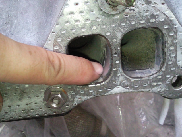

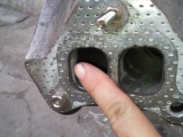

Much better if you Thermal wraped the new header. Personally check if header plate holes was properly aligned with your cylinder exhaust port. You will experience engine vibration and low performance if header plate holes were misaligned .
Below pictures of holes portions needed to be grind off. Our famous muffler work shop here in Quezon City have a very poor job. I have to repair the header myself. I have to grind off excess portion until it match the exhaust metal gasket.

I think sound or noise should still be the same even without the Catalytic converter. Center and rear muffler will take care of the sound. Just recently enjoyed the fc and performance improvement after I repair my header. It took me 3 years to find out the defective job.:banghead:
