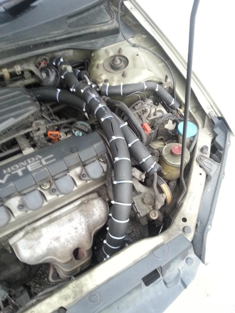

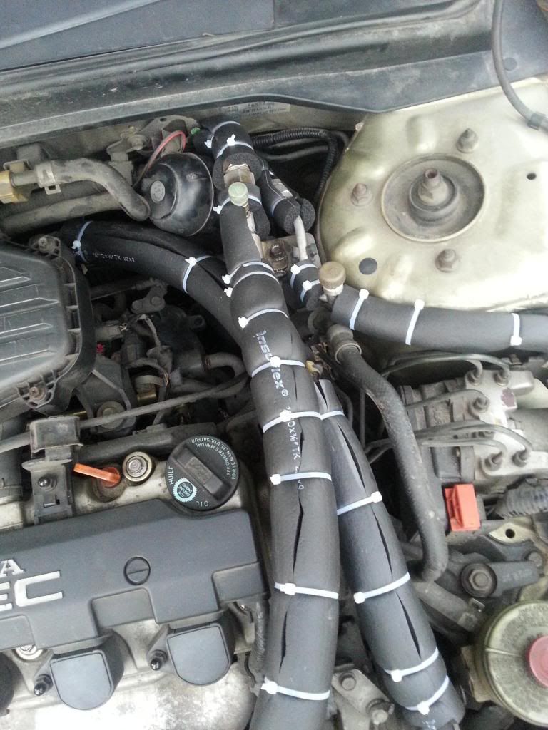

You touched the discharge side of the compressor? :ahhhhh: that is the hottest part of the AC system. The temp is a lot higher than ambient air to enable heat transfer out of the system. Only 2 tubes to be insulated - the cold condensing tube (low pressure gas tube) and high pressure liquid tube just after the condenser discharge.

The high pressure liquid tube also hot, so not sure to leave it to get cool. They are aluminum tubes....

My high pressure line is also aluminum. But the temp is certainly cooler than engine surface and other parts...I touched it and it didn't burn my skin so I guess the temp is around 30C. As the refrigerant used varies between cars, the temp would be diff. So just insulate if the tube is colder than engine bay..

Yup, my aluminum hose is not as hot as the engine of course and it runs at the side along the fender not close to engine. That area I find is cooler then the hose therefore leaving it should better.
Wrapping the suction hose will be my target....:smokin:

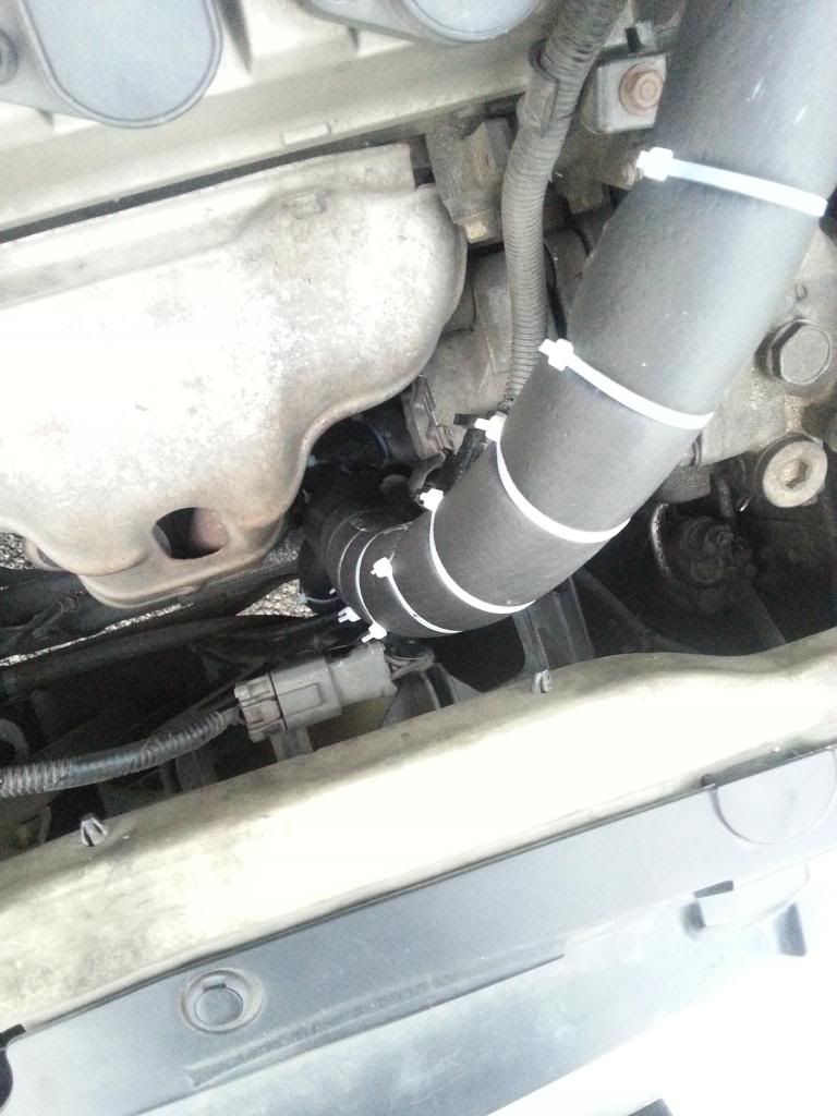

wrapped aluminium pipe from valve all the way 2 the joint of the compressor hose, later if got found sum extra foam will wrap the compressor hose oso, the line after the valve is left as it is

IMHO wrapping insulation in the suction line (outlet from evap back to compressor) only could help to solve water condensation at outer of the pipe, it actually doesn't help increase the cooling effect in our air conditioning. Instead, suction line (outlet from evap. back to compressor) required more superheat to ensure that they is no liquid droplet back to compressor, where liquid droplet may damage compressor. Hence when the suction line wrapped with insulation will reduce refrigerant superheating back to compressor (mean hot air under bonnet act like superheating for suction pipe to bring up the refrigerant temperature or vaporize the refrigerant become gas before back to compressor). Higher the suction temperature back to compressor could reduce compressor work as it need lesser work to compress to high pressure to condenser coil, compression ratio lesser. You many refer to thermodynamic law P-H P-V diagram for better understanding.

True. If liquid goes into the compressor it would spoil. Therefore the refrigerant goes into the compressor as saturated vapour. That is why never set your thermostat to the lowest temp. if the load in space is low, e.g. rainy day or in the morning. So make sure the temperature at suction is not lower than approx -9.4 deg C.
Second thing: higher suction temperature back to compressor does not reduce compressor work but increase it. Very simple question: Why does the compressor needs to work harder when the heat inside a room is high? When the load in suction is high, that means the compressor has to give higher refrigerant flow rate in order to dissipate enough heat at the condensing side so that it can obtain 12~15 deg C at the evaporator coil.
COP of the system is Heat/Work (Q/W). The higher the Q, the lower the COP. :driver:
