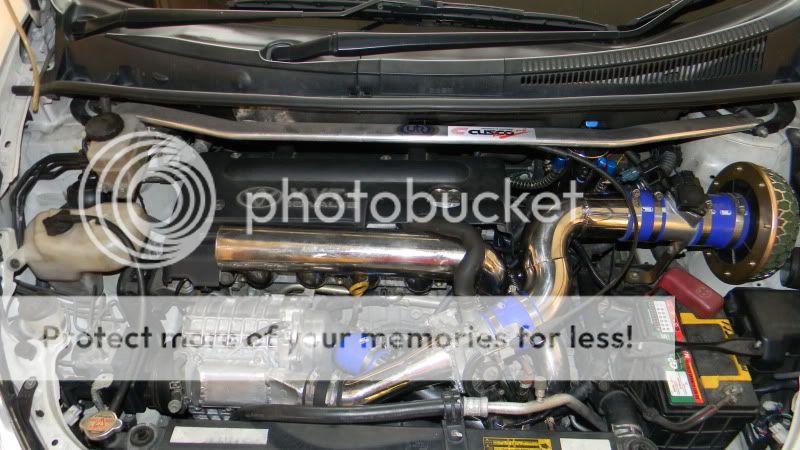

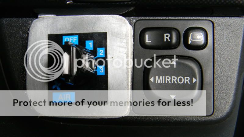

as u wish & 4 da sake of our discussion...(not 4 show off)
engine bay
Controller, can select 1,2,3
1=SC Full ON 2=Based on RPM (RSM setting) 3=Based on Speed (RSM setting)
This is low cost/budget mod (i think so hihihi) , so as u can see clearly all piping, hose, clamp,
fixs 'kira ok la'... myb some might say its not fix/done nicely or myb some other say 'bole la ni'
This project actually is R&D, so 4 me is quite suprise that everything goes smoothly & working well
without any big/major problem. Alternator need to shift to the back of the engine & off cos need
custom bracket to hook up & same goes to with the SC14 (blower/+ displacement).
Now, got 1 kelisa (on going) putting in 1 small SC, i cant recall which SC come from (from which car)

So, do u use back the engine oil for cooling n lubrication or u using an external oil reservoir???
What abt the belting? Do u have customize pulley with a separate belt or u use a longer belt to drive the SC pulley?

Arturo Bro
This SC taken from Toyota Estima/MR2, code name SC14.
its a positive displacement blower & roots type Supercharger
Got another SC from toyota with code name SC12, origin from 4AGE
(if am not mistaken), the different is the displacement.
Speed2Horizon bro
4 this type of SC using separate oil, just use an original toyota SC oil/lubricant,
hence no need return pipe, no need drill the hole, (like turbo setup, need that kind
of stuff).
Am using longer belting 6PK connected directly to SC pulley, meaning no additional pulley.
