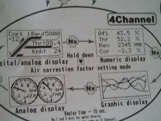

wat mean is thr?
wat mean is knk??
wat mean is afl?
wat can see in graphic display?
