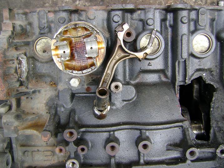

Took off the sump already. Found out that:
- 3rd piston skirt broken (a lil bit only,fell in sump)
- 1st,2nd and 3rd big end/con rod goyang abit.
- Oil sump plate fell off.
Other than that everything seems ok so far. No steel flakes or dust in the oil (at least cant be seen or feel with naked eyes/hand) Need to take out timing belt, head to fully comprehend the damage done. :banghead:

use magnifying glass.
use microscope... hahaha... just attach a scary photo for all to share... forging is the best option to go for an old engine.
hahaha...just sharing mar.that's what they do in the state to check for metal debris in the
engine oil for sign of pre mature wear.:rofl:
