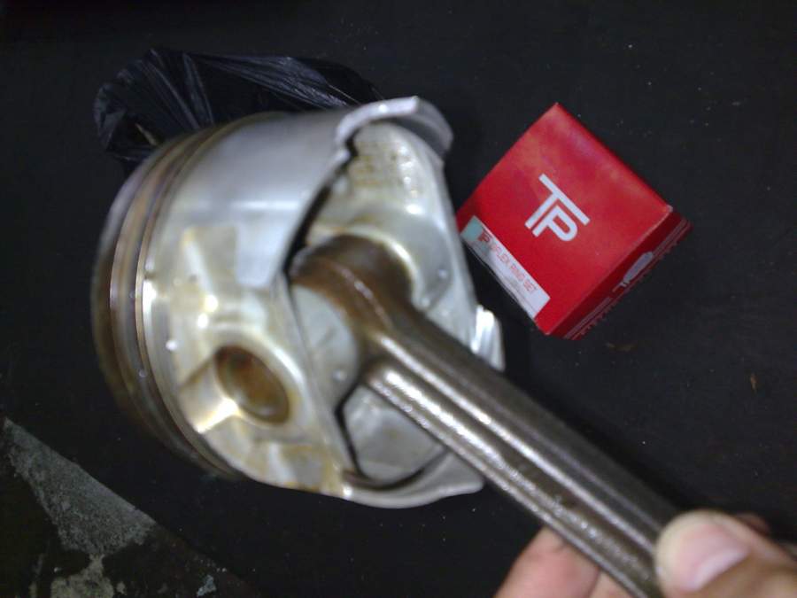

My engine is currently suffering. From my understanding (got knocking sound from block) the big end bearing have failed me. I ran into a problem last september 08 if i'm not mistaken. After installing a new transmission i went to a wheel shop for wheel alignment. The shop was located in front of the batu caves area, got big Hankook sign on it. Everything went well at first, then i was f**ked up by the kid who handled the alignment. Once the alignment was complete he then test drive my car. The dumbf**k was irresponsible enuf dt he went and tarik kaw-kaw my car. Long story short, the piston blow-by.. aftermath of this was 1 cracked piston and broken skirts piece from all 4 pistons. So i had to do a quick fix (no money). They were ONLY willing to pay only half (1/2 price workmanship only). Reluctantly and disappointed, i had to replace the rings, rod bearings, with 2nd hand piston. And now my big-end Failed.

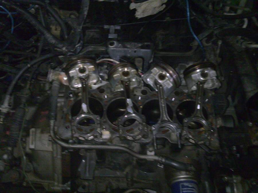

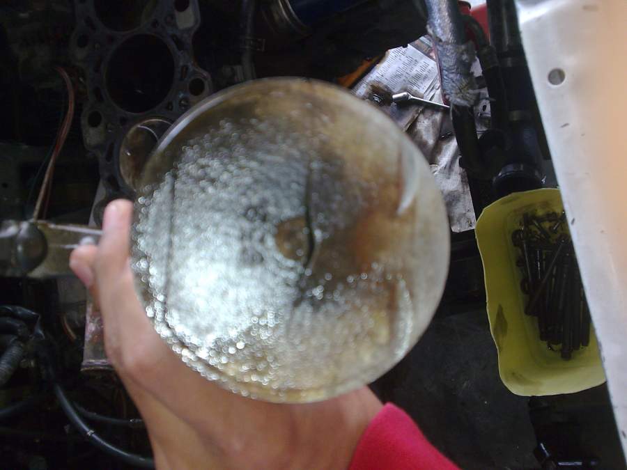

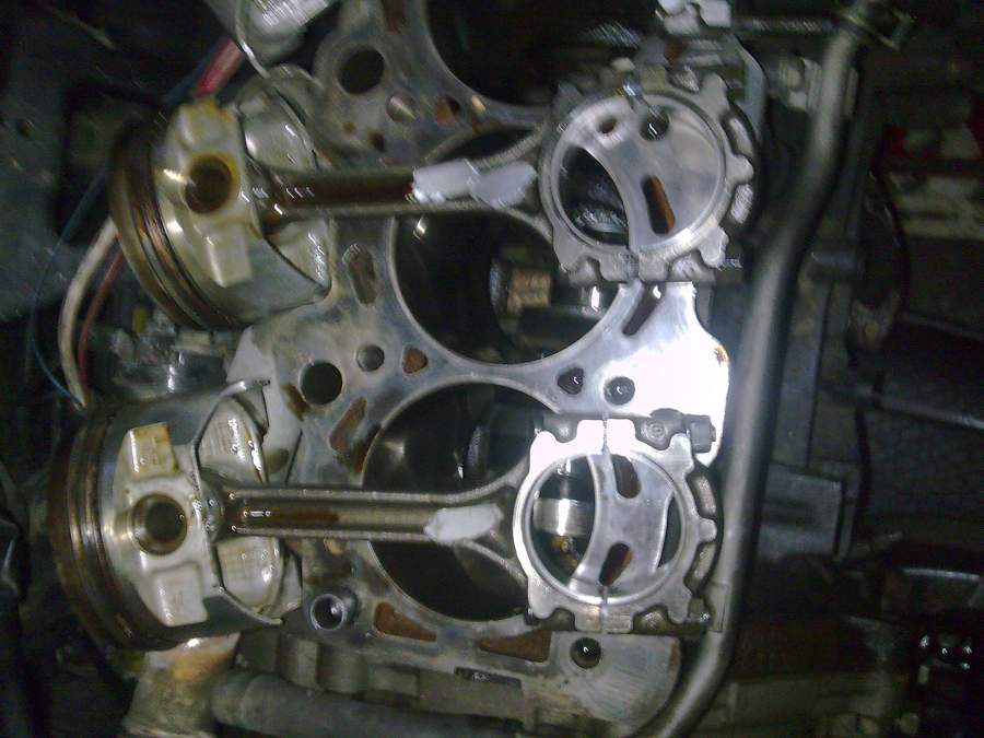

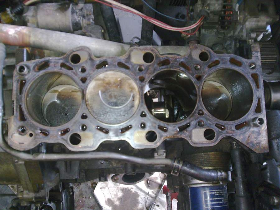

Below are the pics of damage done by alignment shop. Very dissapointed of d misfortune, i cared for the engine with love :bawling:

why did your piston crack in the first place? even though tarik kaw kaw from a good tuned engine shouldn't face any problems. was it overboosting? insufficient engine oil causes your crankshaft to fail on you? diagnose what causes the engine failure first before buying all those "not" needed parts for your rebuild otherwise same thing will happen again.
Example, you and your mech overlooked the weak fuel pump and or oil pump. Even if you use the best available forged pistons and conrods.. they will still be destroyed due to lean airfuel mixture. Get it?

The car was not fully tuned when i went for alignment. Plus i forgot to off the boost controller. Of course the problem is fuel too lean. I think the culprit behind this is the oil screen not properly mounted or torqued. Messing with my oil press thus damaging the rod bearing.
After the run-in period i changed the oil, and there was a small nut in my sump. Luckily i used the magnetic sump nut so the nut stick on the sump nut. My previous mechanic said maybe the alignment shop didn't tighten the screw strainer nuts. Plus my dipstick was stuck on something, oil level on the dip stick is always below low even though i poured in 3.5 liters of fresh oil. God knows what else the freakin shop left inside my sump.

amel666: sorry didn't pick up your call this past few days. i didn't bring my phone with me on holiday. regarding the nut that was in your oil sump what size is it? if it's a 10mm bolts then it's for your oil sump, if it's a 12mm bolts then it's for your strainer and if it's a 12mm nut then pray god i think that is for your conrod bearing cap. from your story there is a logical theory that probably your mech didn't tighten the 2 - 12mm bolts for the strainer and during engine running the bolt came lose under vibration and the strainer changed it's angle and u have the problem with your dipstick getting stuck.
