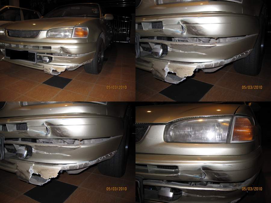

bad day..my car being knock by motor bike today..

aiyoh.. sorry to hear that....
bro, time to face lift to ae111 crystal light already, dun waste time searching for ae110 bumper.. racun racun... hahaha... how is the new exhaust setting? satisfied with the improvement?
hahaha...racun sama dia:evil:
Time to facelifted ur ride la...make it more exotic on the road...but later, need to be even more careful than standard bumper
