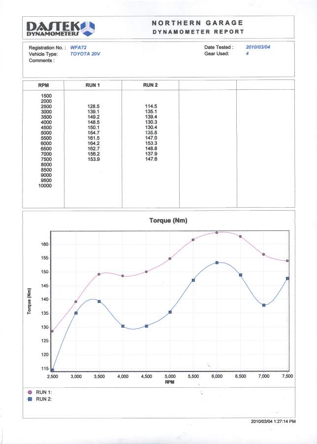

All some updates after changing my exhaust system to complete aftermarket part.
FGK4-2-1 (thanks Bro AE101-Wong) + trust piping Straight flow (thanks Bro scottwrx)
completed the unichip tuning. i recommended to use piggyback/standalone ECU if you start modified the stock BT ^_^ (you will see the diffferent from dyno graph)
forget to put more info
1) stock BT Engine
2) Using Ron95 petrol
3) stock plug cable
4) Open port Apexi filter
5) Sars fuel regulator
6) iridium plug
7) Idemitsu 10w/40 already run 3500 km
8) Piggyback Unichip-Q
9) FGK 4-2-1 + Trust aftermarket Piping
10) Oil cooler kit
11) Redline light weight pulley
