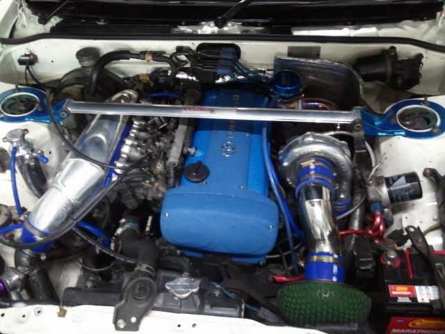

Turbocharged 20V Blacktop
i think you need to pay attention on your intake side especially the intake plenum if you want to keep the equipment stock...for example my plenum rubber seal gone already...i doubt it will hold any boost...it will just leak all over the place...

if boost 0.9......consider high not......
yup.. it's high..
i recommend do a plenum like this.. it's more practical & no leaking problem :biggrin:

the pic i found on d net.. but i think any foundry shop can do this plenum.. with a price of coz..
if i'm not mistaken...thai folks sell ready made intake similar to this...seen it before...complete with trumpets inside...
I bought that RM1400 if not mistaken. Cant remember. Must use that if not sure leak the air. Boost sure drop.

You all can look at my mod on my links. 300bhp dynoed. The way those pipes run also can follow.
done it in East Malaysia bro. You'll look for someone with passion, and i think this kind of tuning car or mech, you can't chase them and ask them to do it fast, end up they'll screw up your things and handover the car for you.
4age 20V BT turbo is reliable if you do it properly.

for NA also can use. bear in mind SVt and BT use different intake.
NA better use a bigger plenum such as tom's carbon fiber plenum and/or trumpet.. for more power NA tune
coz if use the metal 1, it's not big enough.. sure choke ur engine..
if Turbo, u need the metal plenum..
if NA, no need :biggrin:
