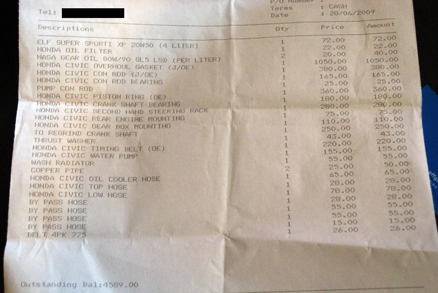

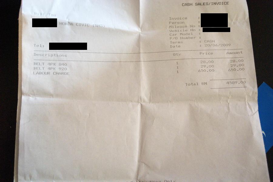

im getting back my car on monday...
grand total for repair is RM4597? fuhhh....
that includes , change bearings , one conrod...one (piston bearing/piston)?..repair back crankshaft
2 engine mounting , steering rack , water pump...timing belt...and all other seals, rubbers that is worn out +semi synth engine oil , workmanship
i hope everything will be fine when i get it back..after spending so much
by the way anyone know whats cam angle?
someone told me..i will loose power if the foreman didnt know how to do it properly
(no idea what is it)
