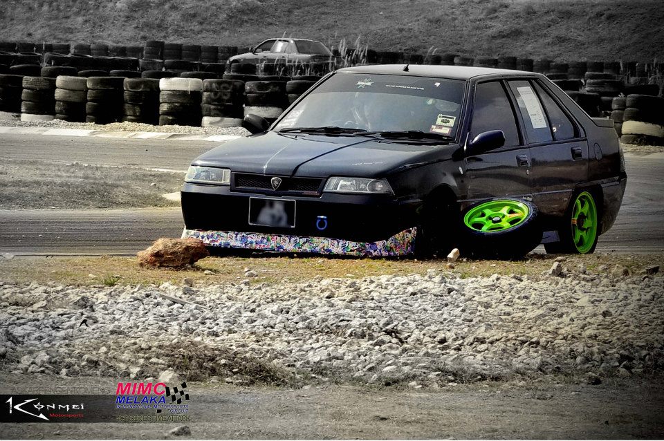

Happened before to a friend on track - but he was using aluminum lug nuts which eventually popped off after it loosened.

What happened to your friend then?
actually lemme see if he'll allow me to post the pic here. :biggrin:
In the end a whole bunch of folks had to help lift the car onto jacks to reinstall the wheel. I think there wasn't any damage
-edit-
Ah screw permission. His number plate is blanked out anyway. :biggrin:
attachment.php
The aluminium lugnut broke or something and his wheel flew out mid corner.

those kedai abang lug nut cant take the stress during track event.
Nothing beats the steel nuts. Almost indestructable..
Bumpers till looks fine. Luckily no major harm done.
