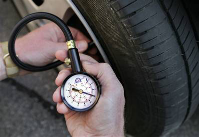

My car left front tyre deflate last thursday and i took out & brought it to a tyre shop. Inflate it, dip into a pool of water to see any sign of puncture or leak but can't detect any. Brought it back, install it onto my car, then drive back home safely.
Next day, in the morning, the same tyre is punctured again. Jack the car up, took the tire out and bring it to another shop to diagnose. FYI, that tyre had a puncture before because of a small nail but had been repacthed. The mechanic use a soap water to check for leaks but can't find any. When i press the sidewall, then can see tiny bubbles coming out but stop if I depress it. Then he decided to take the rubber out to check any problem inside the rubber or the rim itself. Found nothing. No cracks, no puncture or what so ever. He says that most probably due to the excessive dirt or tyre sludge build up on the rim that makes the rubber doesnt sit well on the lip.
He then sandpaper the inner lip of the rim to clear excessive dirt and sludge before inflating air back into the rim. We then use soap water again to check for any leakage again but there's no sign even on the patched area.
Thinking that its solved, took the tyre back & use it for the weekend but did a frequent check on the tyre. I found out that it loses about 4-5 psi each day. Then this morning, the tyre still punctured. I am cluesless right now. I did check using soap water when the tyre is on the car with the weight pressing, still can't find any leaks.
What is the problem actually? It is because of the rims? tires? :banghead:
