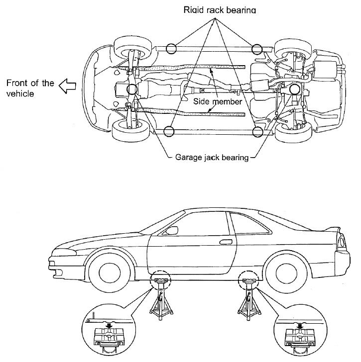

i went to a workshop today and i found out from the mechanic that r34's tyre cant be changed by a normal car jack if we experience puncture tyre in the middle of the road. is that true? and i got a real shock today when i found out underneath both the front tyres where usually we place our car jack were heavily bent inward. r34 do not have reinforce steel for car jack. it will be a nightmare if we experience puncture tyre in the highway.
R34 Vspec II Jacking Points
:burnout:
if that were all the jacking points so it wont be any problem if i try to place my normal jack in any of the point? by the way darkchild, that picture wasnt it an r33?

When you use the jack that comes from the car, it will be okay since the jack has proper grooves to fit the seam.
When the tyre shop guy comes with the workshop trolley jack, and jacks it up at those points, wont the seam be bent? I know mine has been bent a lot!!!!
BTW, my car is not a GTR, just an old banger Nissan... but safe to say that it happens on all cars....
sorry to say most of the tyre shop workers didn't bother to check and locate the jack-up point b4 changing tyres. My car's sill oso bent inward due to that.
The worker didn't tell me when it was damaged, until I changed my own punctured tyres. really blardy these ppl.
That is why I have low regards to these "kim moh" workers at tyre shop.
I think what Zohan meant was that the mechanic noticed that the jacking rails have been bent behind his front tires. To say the tyres cant be changed is untrue, of course u can change the tyres. Perhaps if the rails are bent, it makes it a bit dodgy as the jack might slide off.
