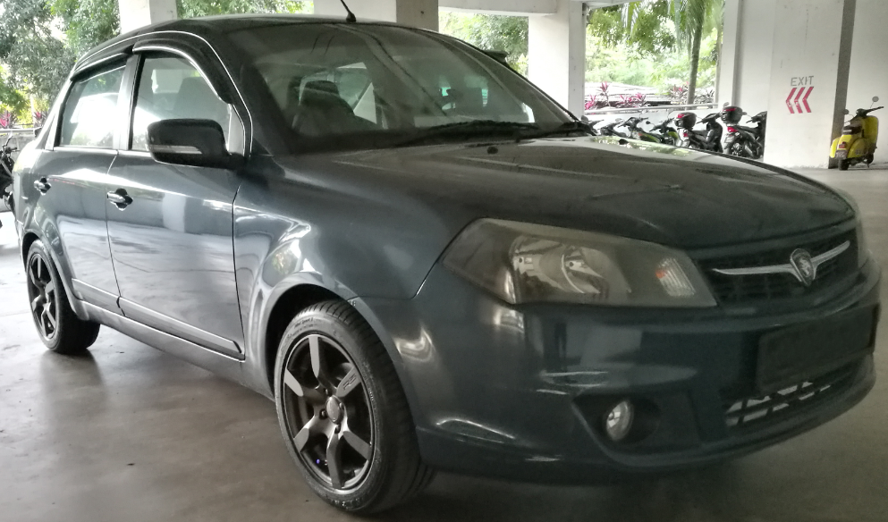

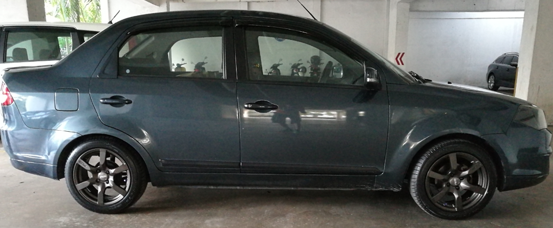

ahh. better view. ahahaha! how's the suspension and handling? since u said it's a third hand, have u changed the suspension and all?
Handling is still tip top given the age and usage. Drove it around Batu Feringgi few months ago and handles like a dream(except for that huge body roll XD).
And that was on worn 14 inch XM2's :0
I havent tried pushing the PS3's yet, waiting for a few hundred K, to break in the tyres.
Good choice on the wheels. I like it.
Paint looks like it needs some love.
Paint will be the last thing I do, need to settle the engine, handling and parts replacement first :D
