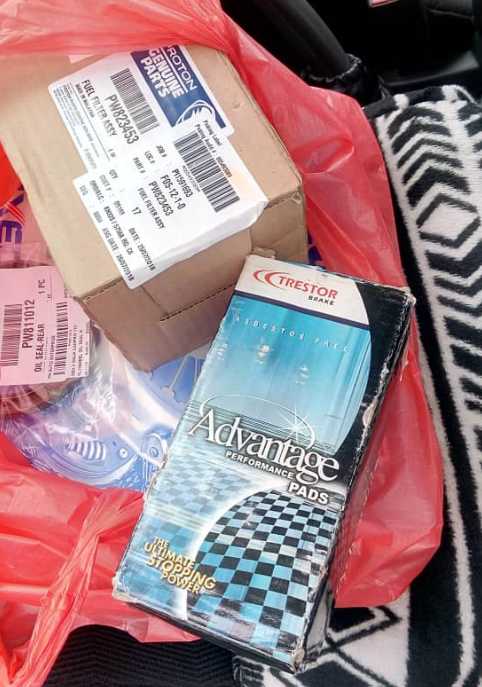

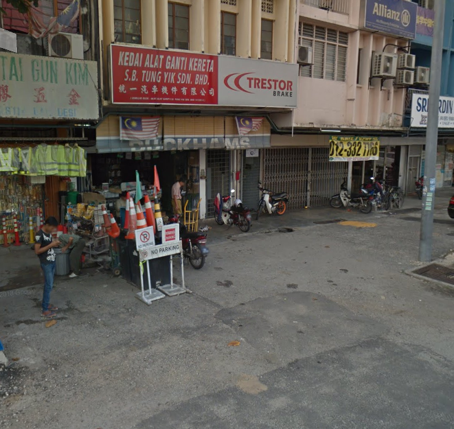

LOL. PH Auto usually got old stock but the uncle there so lazy to find in the store and the price is always inconsistent.
haha, last time bought for bro. Izso the Bendix MK, ask price for front and back set but did not confirm, then bro. Izso say think about it first, straight away the Uncle reduce RM10 each......lol
hahahah! they always like that. today go ask price they say RM120, die die ask u buy and say give discounts. then 2 weeks later go buy something else and then ask the price for the same parts suddenly become RM80. true story. i bought my NOS wiper front cowl cover there.
So far for my purchases, prices still consistent but nowadays buy more from Bay Brothers, nearer my place, easier parking and I can ask first using apps, which they reply quite promptly .....lol
my favourite place. ahaha. but bay brothers dont have trestor..
