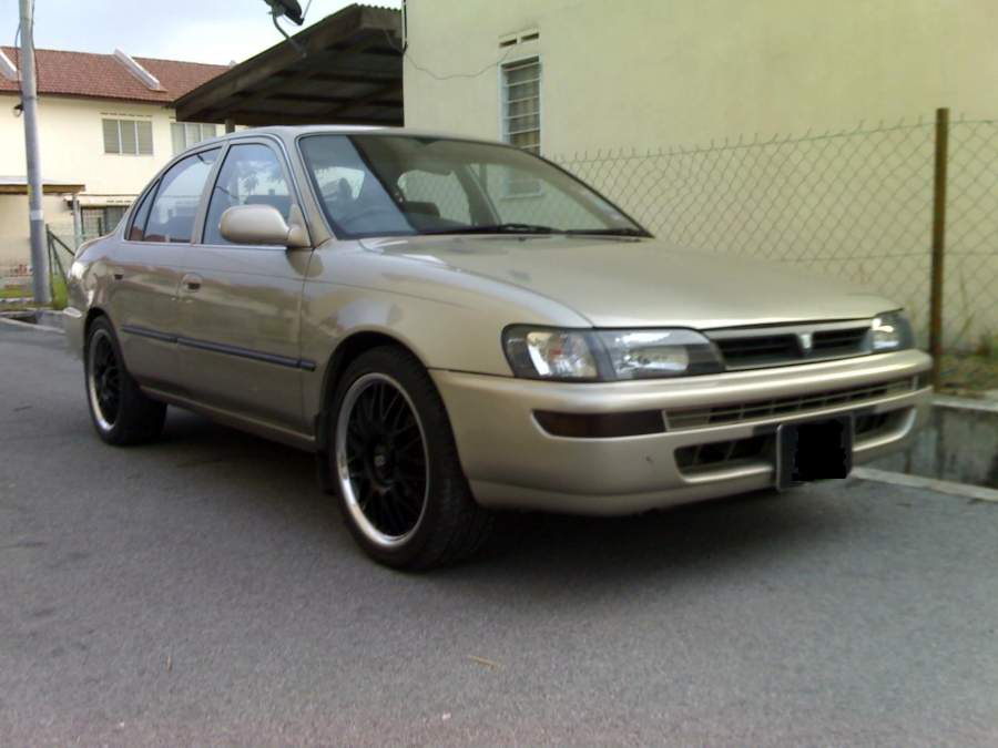

so u can post ur car pic la...hehehhe!
this is my car pictures.

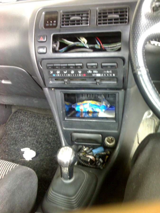

speedo meter memang sudah rosak. so tak jadi modific waiting for wagon meter. radio belum masuk. tempat kunci kena modific to fit the ae111 steering shaft cover.
12/1 actually already started. but complete pasang balik semua on 17/1.

speedo meter not contact i dont know where to check so decided to buy wagon or gt meter.
engine good running without any problem but this 6 speed ada sikit leceh la mau masuk gear reverse. maybe still new.
