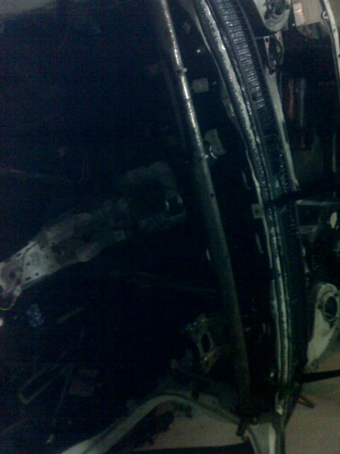

yesterday morning i completed removed all wayering and dashboard from my ee100. so hard than ae111 because the wire tide in the dashboard.

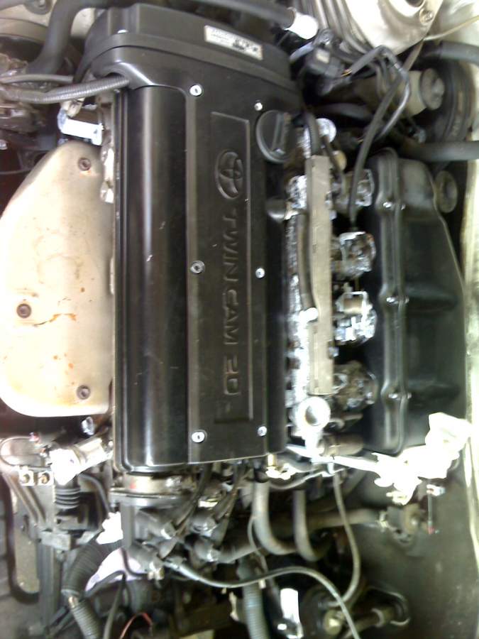

on evening i completely take out the engine from ae111 after write down all the wire for easy connecting later. this process take around 2 hours because bigger engine as engine bay. after engine took out i check the timing belt its still new (maybe 2 month used the toyota sign at belt still good).
i start fitting the wayering from ae111 to my ee100...not easy have to patient on that. that process i did it at night with lighting. not so hot with sun.
this morning i removed power steering and continue wayering untill evening. now im at office working night shift. tomorrow will continue my engine transplant project.
