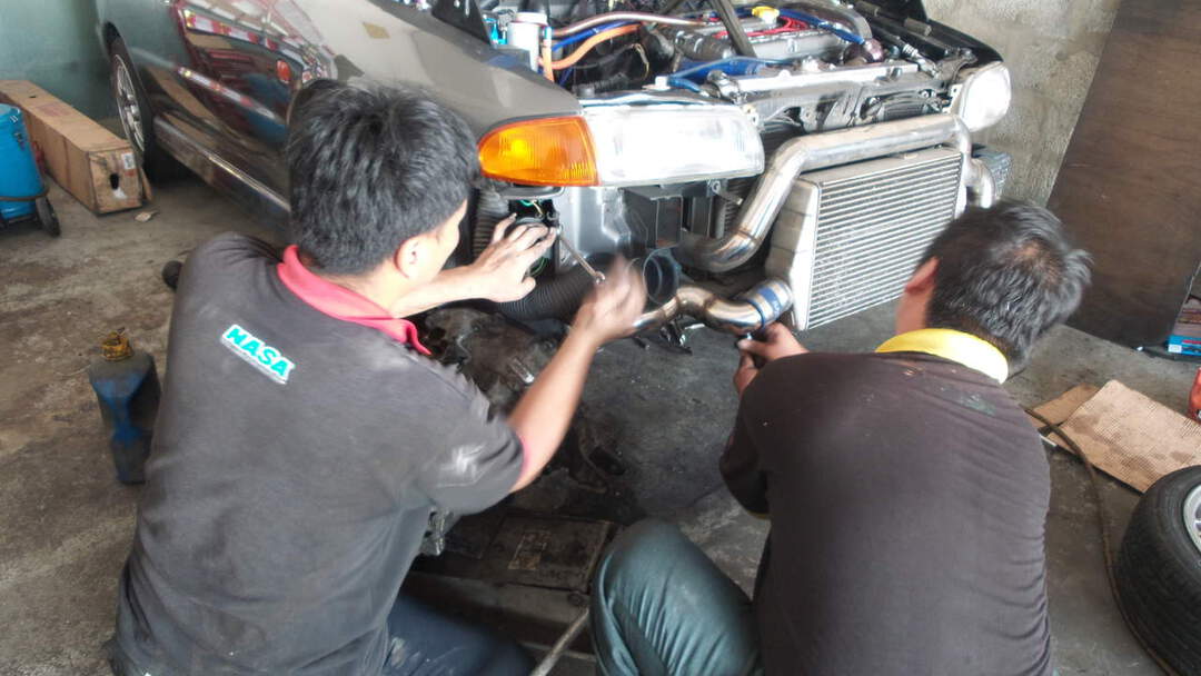

and then i changed new lower pump u know what happen? still cant press clutch, turun gearbox (4wd damn hard to open btw) .. then saw the bearing fork makan dy.. damn need purposely find it tomorow![]()
,1 day delay.. nvm, but after that they found out kl supplier dont have for ce9a but c99 gt, then try my luck order c99, luckily it is the same:proud:
it is still running in period, hope nothing went wrong till i go on the road tuning(again, here so ulu,dont have a 4wd dyno so need on the road tuning
)after a day waited, the mech turun gearbox and found the clutch bearing release fork and fulcrum kena "makan" that is why can push the clutch cover to engage clutch.. then going to find it, proton parts dont have with them and all other spareparts shop say so(finding satria gti fork and fulcrum since xtremeleo tell me it is the same) ... then try my luck go chop shop, finally found one 4g93 fork which is the same.. bought for rm80 .. then cant find the fulcrum.. go the expensive parts shop which sell all ori parts, found out part numbers of the fulcrum for satria gti chassis c99 and evo 123 cd9a and ce9a are different... they dont have parts but can order from semenanjung,1 day delay.. nvm, but after that they found out kl supplier dont have for ce9a but c99 gt, then try my luck order c99, luckily it is the same:proud:

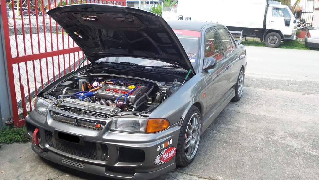

finally the car is done and i am driving around and go home with it happilyit is still running in period, hope nothing went wrong till i go on the road tuning(again, here so ulu,dont have a 4wd dyno so need on the road tuning
thank you the mechanics friends so hardworking,after my item arrive direct pasang up gearbox then make the car complete ...
and finally it is done for run in,and the famous hydraulic lifter sound also gone,i think it is fully oiled and running good and silent
