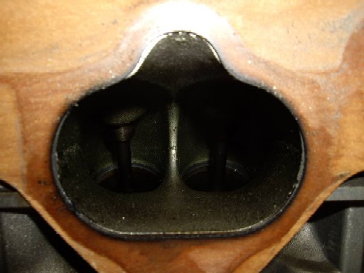

Attached pictures are nothing spectacular. They are just pictures of the used B16A PR3-1 head of an EG I got from DC_vtec last night. They are currently totally stock and will be going to my mech for porting this week.
Enjoy the pictures of the std head if you haven't seen one before yet.

Haha.. underwhelming.. looks like a good candidate for a makeover..
Let's see what kind of valve job you're opting for.. Recessed valves seems like a good idea for valve piston clearance, but how about the rocker arms? Hope to see how yours is done.

From what i know from my mech, they didn't do any valve job on my head even the current ones running in my B18C that made 200whp.
He did one custom valve job on a previous setup but it did not make power pass 8000rpm. Think he over done it.
But i know he is doing more work on valve job on another head that is going on an EK for testing this week, so we will see how it work that car 1st. hehe...
No valve job but yet it flows really well. Strange but this what i'm told..
But then again, I told you before these mechs all tend to keep some secret to themselves and not so keen to reveal too much as they worry other mech will learn too much. Sometimes when i find something new or interesting facts, i'll go over to tell him and he will just give that look and say "ya, i know. we have doing that even on your engine". I was like "how come you never tell" and he will say i never ask. hai ya.. these people...
But this built i will try to snap some photos after its been mildly hand ported.

Actually that's one of the manufacturing quirks of casting.. some come out very nice.. some come out with flashes and needs to be cleaned up. I think even the size of the ports are varied a little from one to another, and I think that's why some cars make really good power when stock, and some not so.
Actually I think the stock heads flow pretty well, so usually just cleaning them a bit would be good enough... Observing the port and polish work of another head from Japan last year (or was it mid 2005?).. it looks pretty much close to stock, except for some parts, esp. the bowl area where the valve guide juts out, and the turn that leads to the valves... damn.. it made me want to DIY mine.. haha.. The porting was meant for a 2.0, so I guess 2.0 NA don't need huge ports like what americans do.. but well.. americans like to turbo their cars, so that's one possible reason why.
In my thinking, big ports only make power for high revving big CC engines that get's choked on high rpm air flow.. small CC cars, the engine waste too much power trying to pump the air in... (well in theorylah.. mine)
Low end always suffers though when using big ports.... I think you can see it from vids of how some all motors launch off from the starting line.
