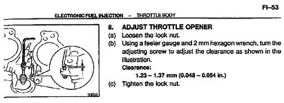

As far as i concern, the Throttle Opener that attach behind the 4-throttle act as auto choke. Before vacuum is exist (before started the engine), it slightly push open the butterfly, just like the paddle is being push down slightly. When vacuum is exist, it let go the butterfly. There is a screw to adjust the opening angle of the butterfly. Some tuner use this screw to bypass the ISCV and control the idling. But by doing this way, TPS need to be re-adjust together.
Adjust Throttle Opener - refer to BT service manual EFI pg.53
