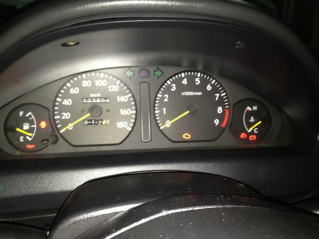

Hi guys glad u guys can help me out too here thanks.
My check engine lights up and my idle is below 1k rpm, when try to rev more then 2k its like choke and letting got the accelerator the engine died:confused:
I check my spark plugs all okay and fuel is enough from the fuel lines what could have cause this? I check the ecu too like look out for burn mark but nothing all okay to me. Reset it all by removing batt and ECU adapter still not fixing anything.
What else I can do? Any sensors I should check? Any good BT20v workshop near by Setiawangsa?

The check engine lights up as usual when ever the key is in the ignition is on then I did the wire jumper method and my check engine doesn't blink at all, thanks again sir will try to plug in different ECU
