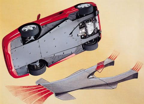

a little visual aid on underbody flat paneling
BAD
http://www.scienceofspeed.com/products/general_information/JGTC_GT500_Underbody_Diffusers/disrupted_airflow_under_sto.gif
GOOD
http://img84.imageshack.us/img84/9071/ferrarienzoyn4.jpg
http://www.scienceofspeed.com/products/general_information/JGTC_GT500_Underbody_Diffusers/JGTC_GT500_underbody_diffus.gif
