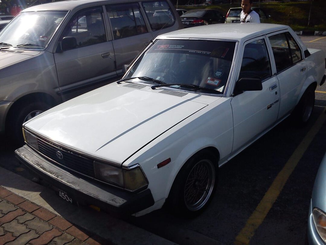

Here's my 'new' KE70..
http://www.zerotohundred.com/newforums/members/d7zul-albums-my-new-ke70-picture7298-ke70-front-2.jpg
http://www.zerotohundred.com/newforums/members/d7zul-albums-my-new-ke70-picture7296-ke70-4k-2.jpg
http://www.zerotohundred.com/newforums/members/d7zul-albums-my-new-ke70-picture7300-ke70-rear-1.jpg
http://www.zerotohundred.com/newforums/members/d7zul-albums-my-new-ke70-picture7299-ke70-front-1.jpg

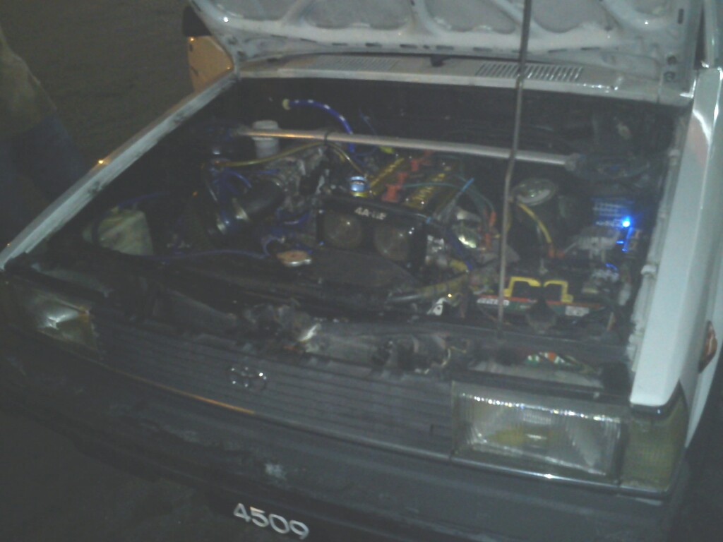

here's a sneak peak of my dad's KE70 4AGE..
more pics coming soon..
and yeah.. i know.. it's white too
:biggrin:

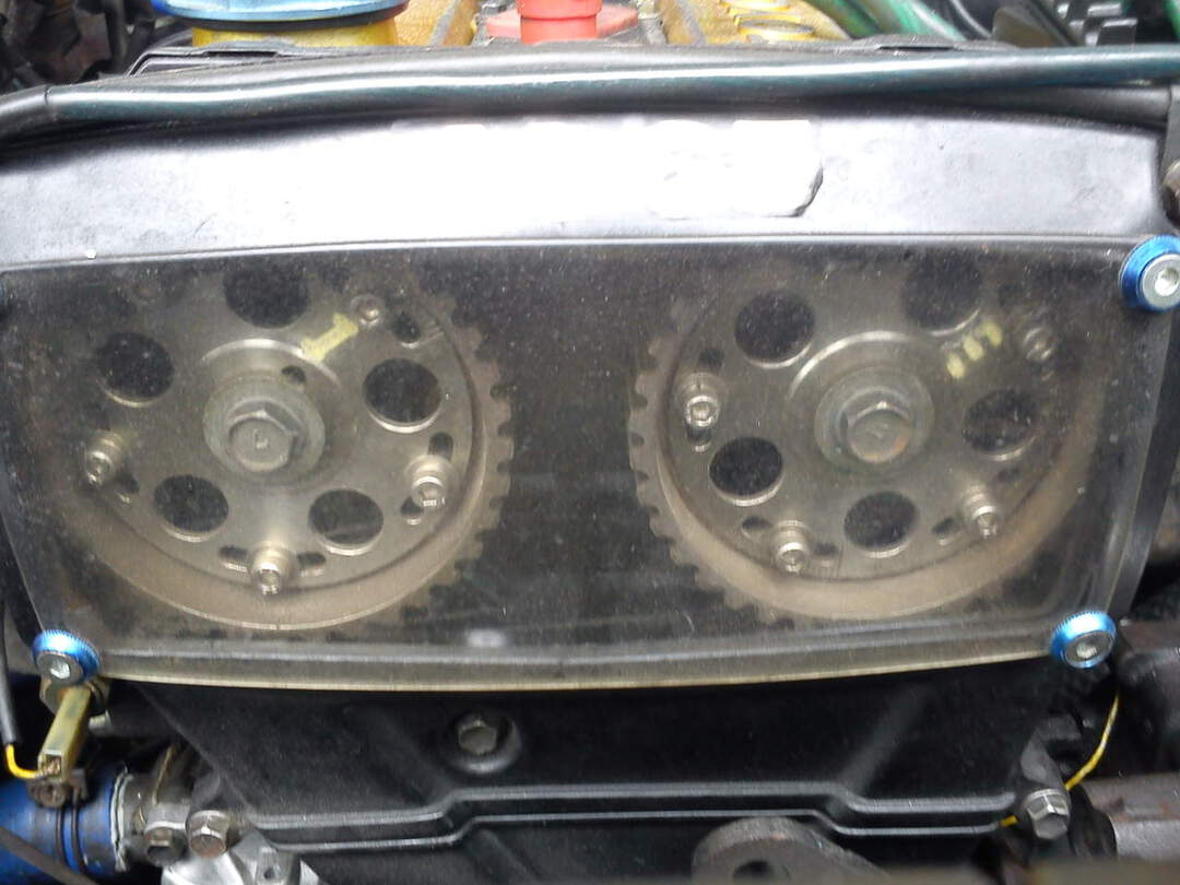

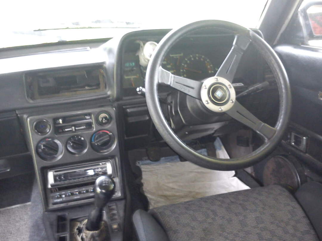

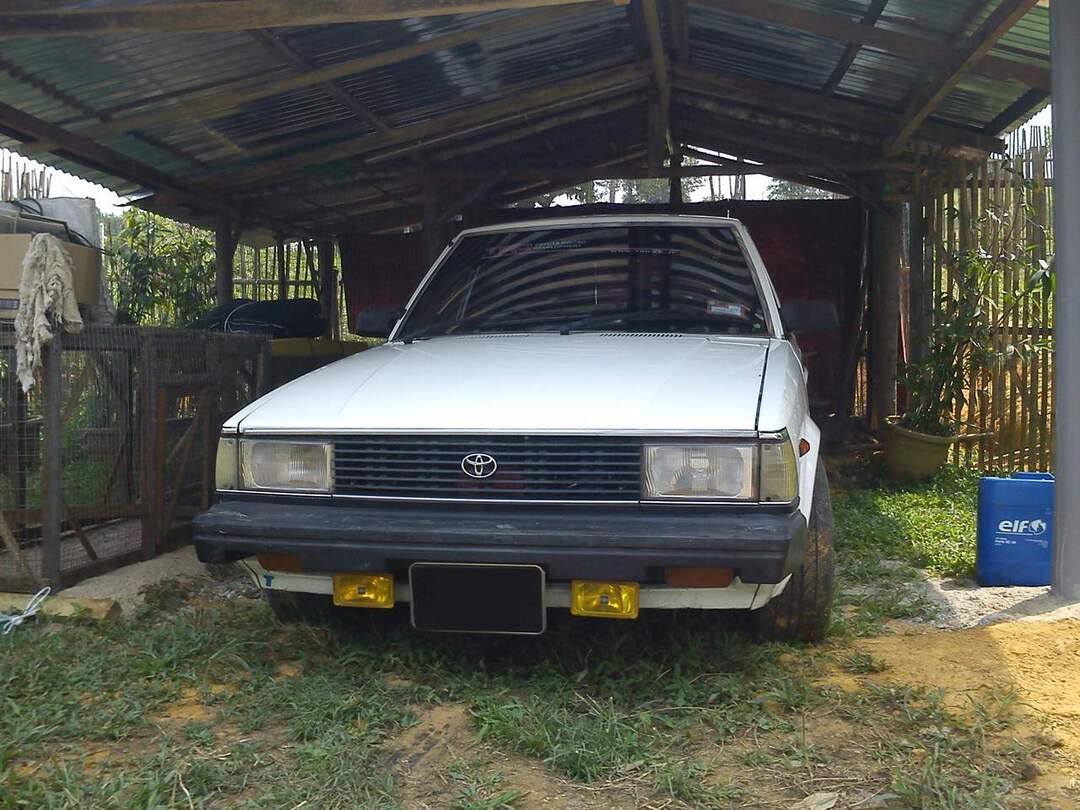

finally, my dad's car pics are here!!!

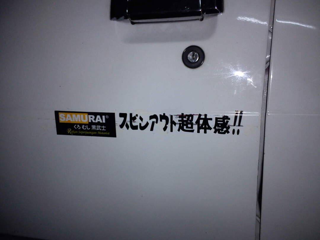

anyone knows what these wordings meant?

Bro ur dad's ke70 is running on a carina half cut. hehehe. the dash is slightly longer than the ke70 and 86 cause its a bigger car. hehe but the rev is 9k compare to 8k for the 86. Nice ride..
I got the ori carina w black top but got stolen. Now runnin a 71 w 86 heart..
hehehe...
If got the ori carina w black top but got stolen. Now runnin a 71 w 86 heart..
hehehe...
serious???
i haven't had the chance to be 'alone' with the car to test the 9k rev cut.. hehe
thanx 4 pointing that out..
i'll keep u posted
:biggrin:

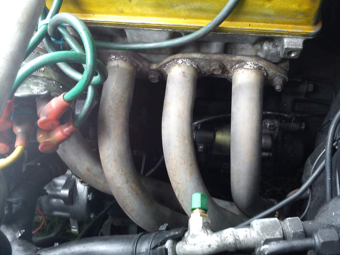

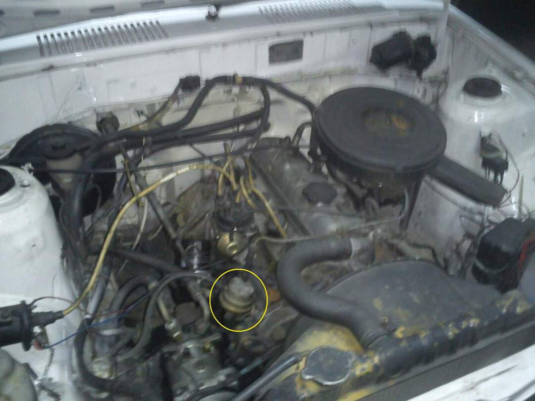

Arghhh.. I GOT PROBLEM..
my 4K engine when i slow down in gear 2.. everything normal..
then i full throttle it, it goes jerking... do u think it was the clutch plate?
at 1st i thought it was this thing (refer pic) coz it was leaking fuel..
after change it, still d same..
any ideas?

time to upgrade the carbie :biggrin:
u've read my mind.. haha..
still not satisfy 'playing' with the stock carb.. i think wanna maintain it for a few more months.. juz wanna know the highest potential of the carb..
i'll clean the carb & check spark plug 1st..
thanx guyz..
:biggrin:
D7zul,if u want very good aka low fuel consumption & a little powah then u can consider
the megavalve aisan carby...hehe...
http://img88.imageshack.us/img88/1416/4g15mit.jpg
http://img204.imageshack.us/img204/846/image620u.jpg
if u are those GK then better go for weber dgv/dgav dual barrel progressive carby or DCNF 36/40...
oh ya...forgot to tell u that u need to use the long reached spark plug for ur toyota 4K engine...due to the combustion chamber design...normal spark plug can be use but the umphh tarak~~
http://img146.imageshack.us/img146/7245/image893y.jpg
sry for the blur pichas...using lauya phone...
BLANk,
those carby plug & play ka?
nope...need to custom tapak for them to fit in...price around rm200-rm300 depends on the material,size & etc...
i done mine for rm230+ in segambut foundry shop 2 years ago...
changed my spark plug to a toyota genuine set (as per the box)..
and the jerking is gone.. awesome.. :top:
thanx BLANk..
this spark plug is highly recommended for 4K engine..
cost rm50 per set..
now can drive 60km/h in gear 5.. hohoho.. (if lazy to drop gear).. hehe
スピンアウト tu maknenye spin out
超 tu maknenye sangat/super
体感 tu maknenye feel/experience
so スピンアウト超体感 maknenye macam really/very very feel the spin out! :burnout:
Special thanx to doritezza for translating
:biggrin:
