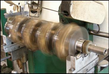

Labour included. Crank deformality can be detected once it's on the balancing jig, not by naked eyes or any hand-held measuring tools.

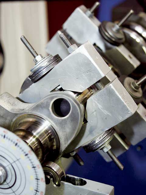

em... dynamic balancing
Drex, if the crank shaft is still good so the cost will be less than 3K with the labour included loh...not a bad price.
I sense that the engine could still have more internal upgrades. Drex what else can be upgraded if 1 choose to do this? I mean what other available parts that 1 can still put in during the rebuilding process. Rods, bearings.etc
for bottom end you may do the dynamic and static balancing for crankshaft, conrod, piston n the ring and maybe can use floating piston pin if the machine-shop know how to make/machining it...
at last use racing bearing for conrod n main if available la...
