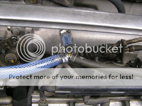

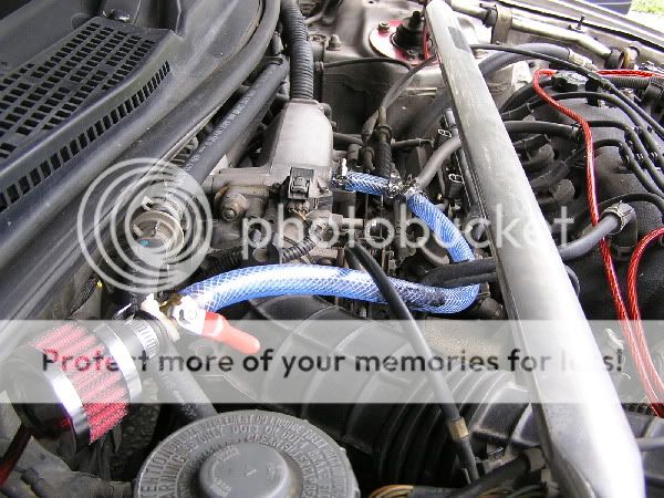

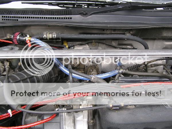

Ehh,that picture hose will so long arr??
suck the hot air and cool air hv driffrence mehh??
It only small filtter,no sport filtter worr
My hose very short lehh,10cm for on the pcv hose only
