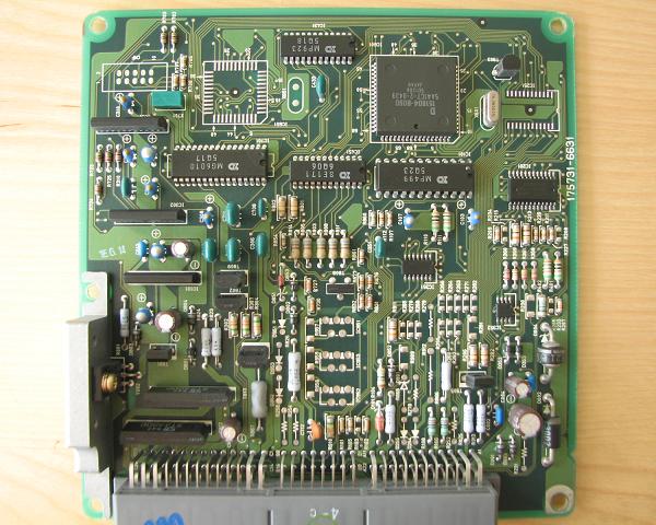

[5sp ECU]
89661-1A470
Grey connector
7800rpm
[6sp ECU]
89661-1A860
White Connector
8200rpm
*At cold weather, the ECU allow 5% up in the rev cut
*6sp ECU has more aggressive fuel mapping compare to 5sp
*Both ECU has exactly similar component count and board lay out pattern
And yes both A/T and M/T ECU share the same connector, pin-out and even the board lay out pattern
Attach pix are 5sp ECU

done comparing both ECU last night and found out that both are same. However i'm still not satisfied because there must be slightly different for both ECU or else why toyota produce this kind of ECU for both transmission? hmm, my last thought is perhaps the seller con me? :mad:
Check IC601's software masking code.
5sp - D151804-8080
6sp - D151804-9531
This is the chip that deliver the differences.
---------- Post added at 10:37 PM ---------- 6 hour anti-bump limit - Previous post was at 10:11 PM ----------
It is not all 5sp and 6sp ECU has IC601 with above masking code.
I have seen (only once) 5sp ECU with D151804-5xxx, and also a 6sp ECU with D151804-7xxx.
However, most 5sp and 6sp ECU has 8080 and 9531 masking code.
hi bro levin818,
referring to your pic and i found out dat its indeed a 6 speed wit code D151805-9531
thanks again bro. really2 appreciate your help.
