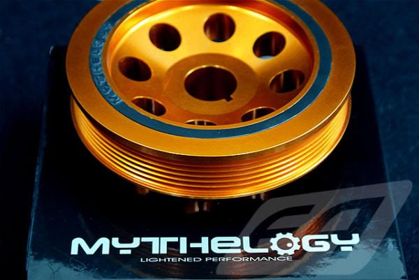

Amir, pictures pictures. The crank pulley for VDO and MMC are very different

That looks like a VDO 4G15. Let me take a picture of my crank pulley then you can compare with yours to see if yours is the same.

Aiya.. I forgot to take pictures. Basically the pulley looks like this (it has teeth at the 2nd cog)
The MMC one looks like this :
MMC doesn't have "gigi".
