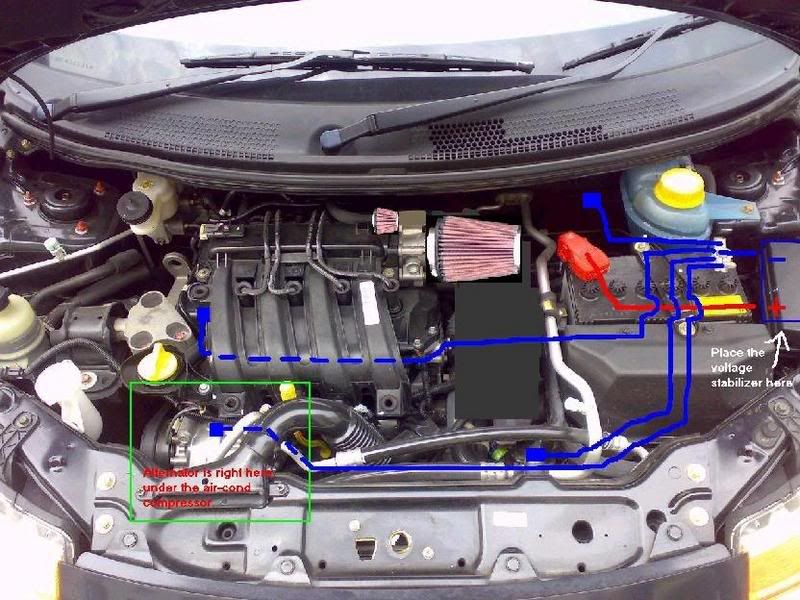

but im not sure where to plug to the alternator, the distributor and the body earth.the terminal installation and blablabla...
The most effective way for the ground wire to place is:
1)fire wall
2)alternator
3)cyclinder head
4) intake manifold.

bro cartoon, im not sure where is the alternator and distributor in my car and where to ground it...

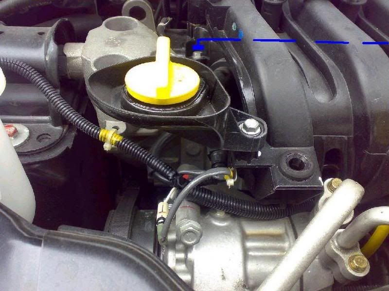

Ok, here is my suggestion where you can place the grounding wire and some of my idea. ^_^
The alternator is right bellow the air-cond compressor.
By the way, savvy don't have distributor, it is direct control by the computer.

To avoid suck in more heat from radiator, picture above is my solution, now you have more space to put in peace of metal to block the heat from radiator.
