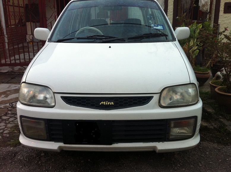

1. The white mice...it's small, it's white, and with cataracts. Perfect candidate!
:love:
2. Lets take it closer....its that a whacked bug on the fog lamp? :mad:

8. The result is very promising. This is a 50-50 shot. Driver side done, passenger side has to be done.
9. Finished both lamps and took the ride outside for a shot. Not bad and I was quite satisfied. Notice that the driver side fog lamp is still blurry. I found out that the fault is actually from the inside :mad:. I cant do anything without dismantling the lamp. My friend did not mind and is happy with the result so I dint go any further.
So there it is. The method works! Most of the people who used this method said that it will last for 1-2 years, depending on how severe is the weather. I'll keep you guys posted every 3 months if possible. Thanks for readingzzzzzzzzzZZzzzzZzzzZz ~:sleep::sleep::sleep:
