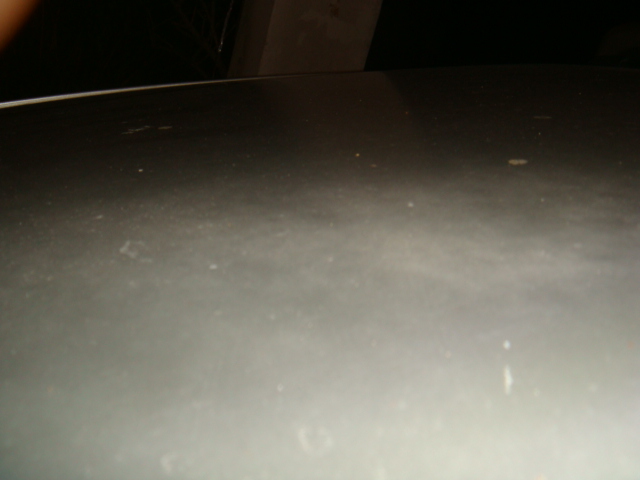

Let's start... To begin, the paint is dull, oxidised, unattractive, dry, and the white appeared greyish. Not washed for 2 years, I suspects that a lot of contaminants have bonded to the paint because After a good wash, the white still appear slight greyish. And some time ago, this mysterious brown spot that nobody knows what is it just appeared... Started out not so dark and it got worse by the day...

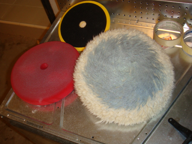

- Compounded don't know how many times with OHC and wool pad (speed 2.5 to work); then polish with OHP and optimum red cutting pad (speed 2 to work).

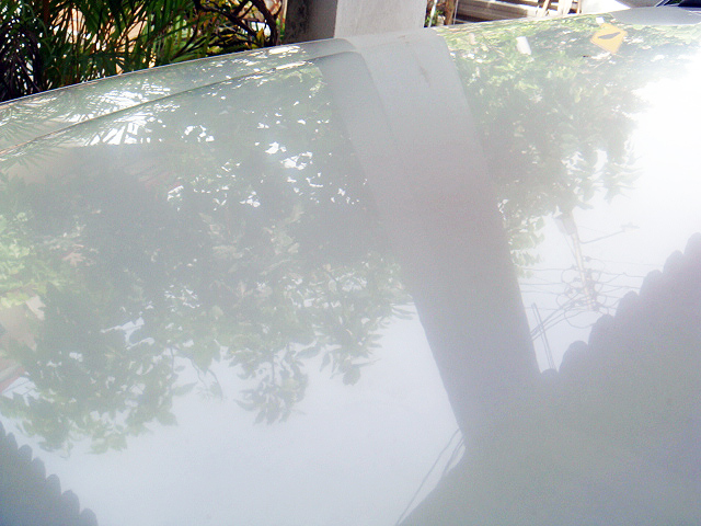

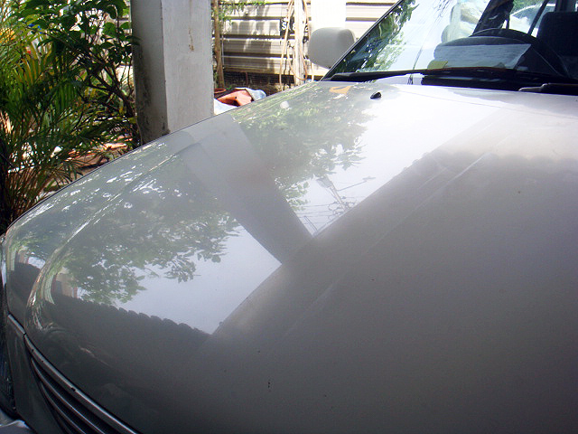

After everthing, Tada! Gloss restored... I love the reflections...
attachment.php
attachment.php
attachment.php
attachment.php

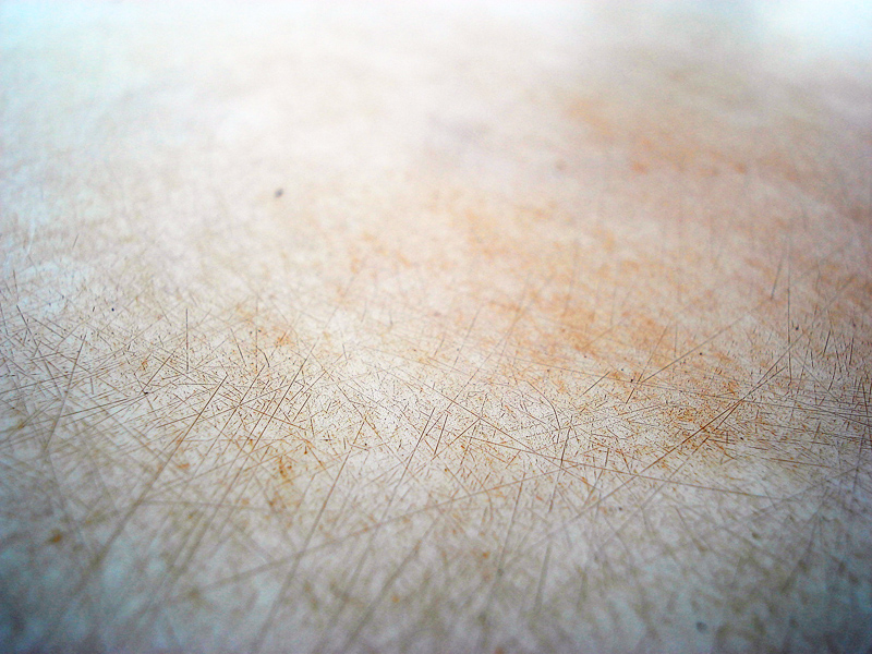

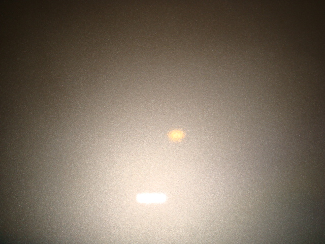

But under close inspection of light, what the??? :confused: Why I always compound also cannot remove the swirls and scratches? I don't think I didn't compound and polish enough because until the paint already thin.... :banghead:
http://www.zerotohundred.com/newforums/attachment.php?attachmentid=383323 http://www.zerotohundred.com/newforums/attachment.php?attachmentid=383328

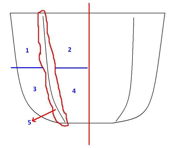

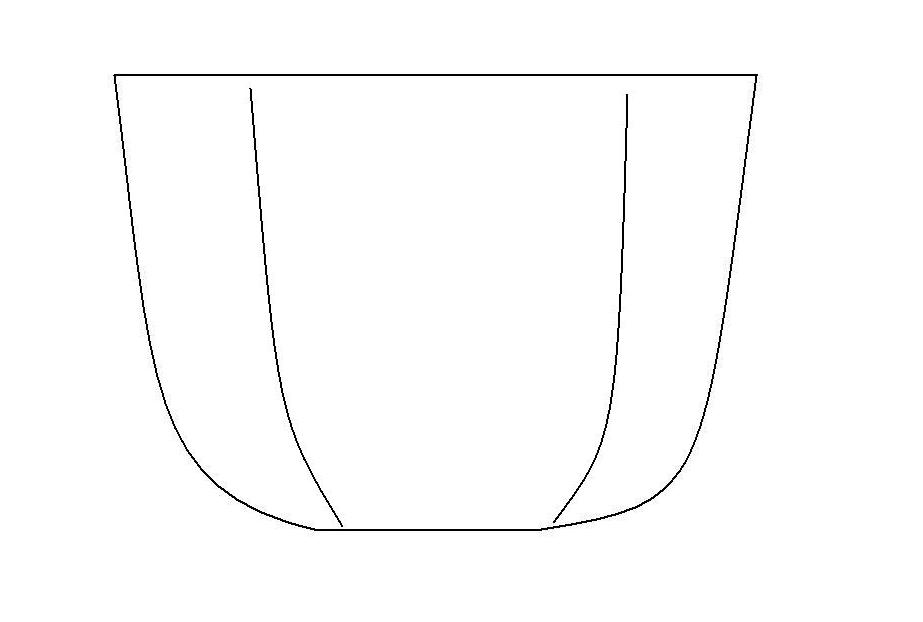

This time, I used and wasted a lot of product because of poor panel division... This is what I've learned when trying to divide and polish contoured panels... The car's bonnet is curved with lines and trims.... Like this here...
attachment.php
By default, I divided it into 4 areas like this... This is what most website teach too.
attachment.php

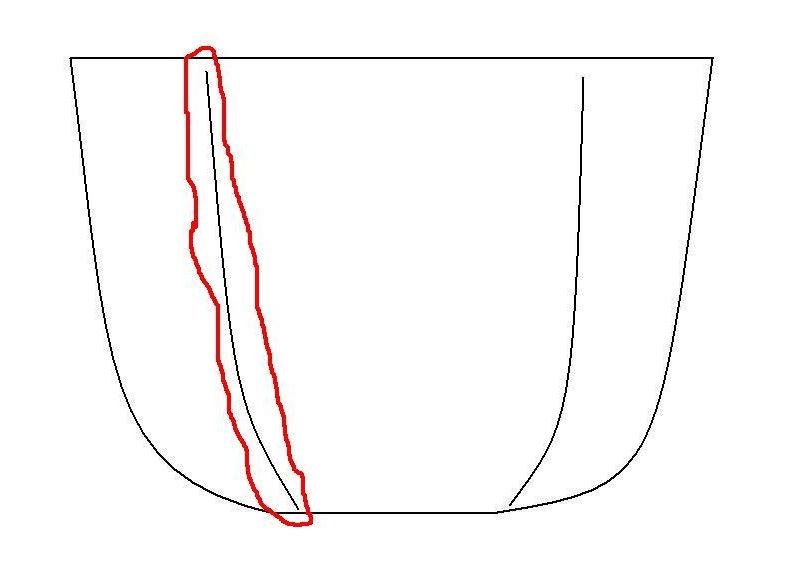

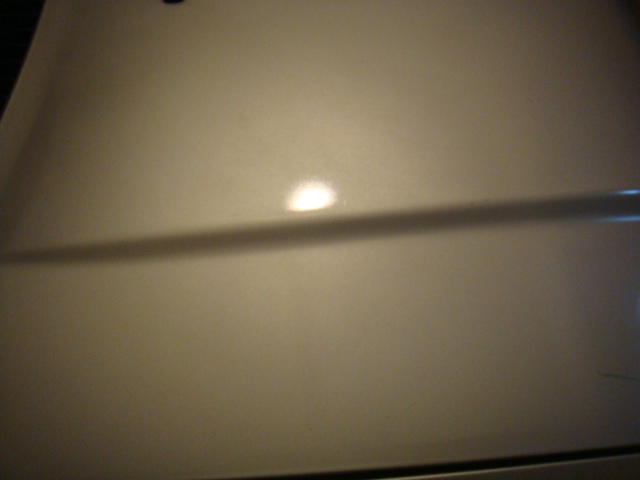

But there is a contour here, in the place circled. Like a small step. After I compounded, I found that this place didn't get worked well and was dull and have lots of product splatter... Because there is a step and the wool/pad seems to skip over this area.
attachment.php
So finally I divided it this way... I did along area 5 first (where the countour/step is), carefully with the side of the wool/pads. Then proceeded to area 1, 2, 3, and then 4. Then all places get worked evenly...
attachment.php

some scratches are not worth to remove if cut through really deep (single stage: close to primer / clear coated: close to base coat) if you insist to cut all the scratches you'll end up cut alot on the paint/clear coat. and also some scratches are cannot be removed no matter how much you cut.

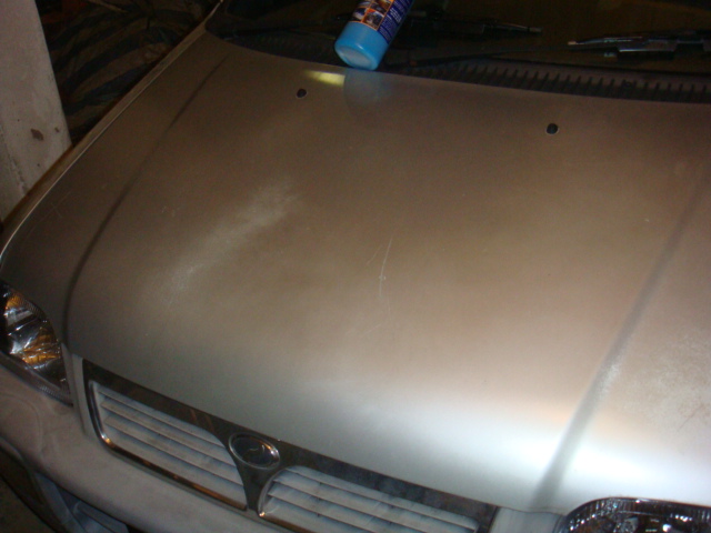

My fourth try...
My friend's kancil due for repray.... You know what this means la :biggrin:. It means an all out battle!!!
This car is parked out under the unforgiving, merciless sun of Sabah (heat more aggressive than KL) for about 5 years. Side panels are still okay but the roof and bonnet are largely damaged with clear coat failure (oxidation and even peeling!). So I got permission from her to try to fix it!

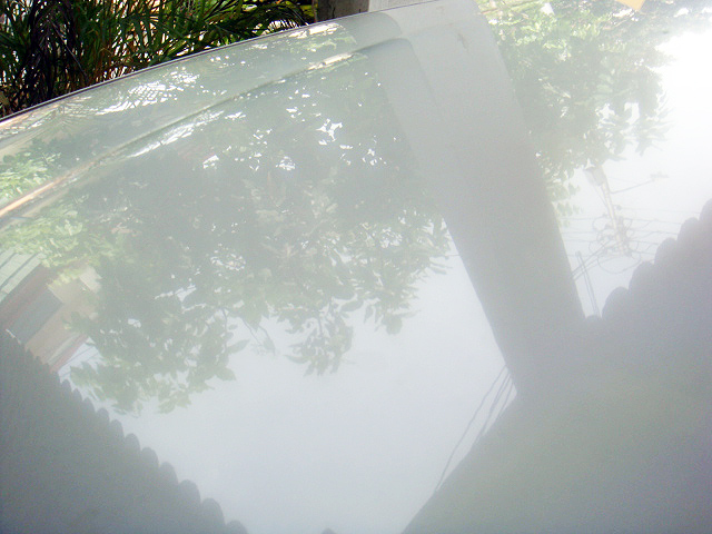

As you can see, most of the horizontal panel is badly oxidised witht he paint looking dull and white patches all over.

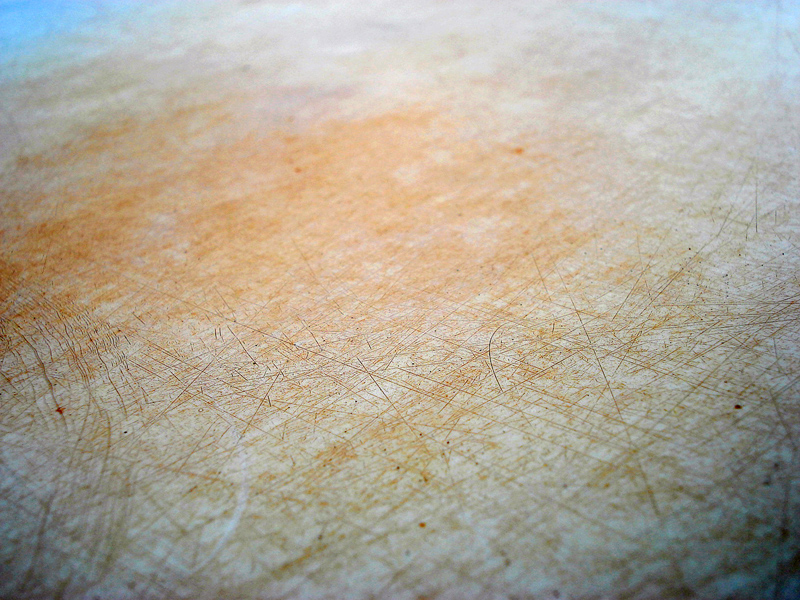

attachment.php
Close up
attachment.php

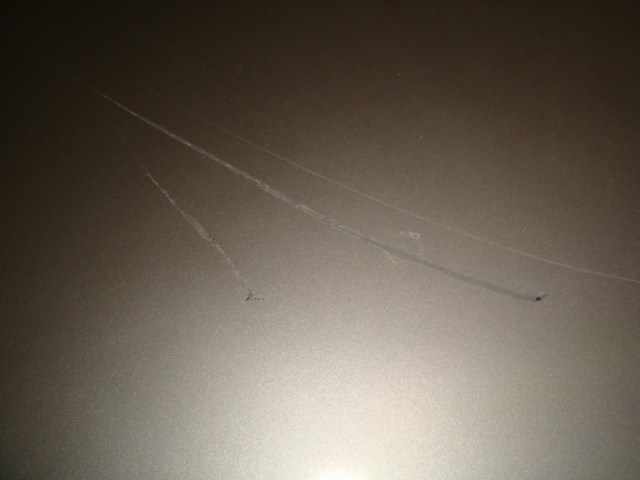

There are quite a number of these really bad, deep scratches to the primer.
attachment.php

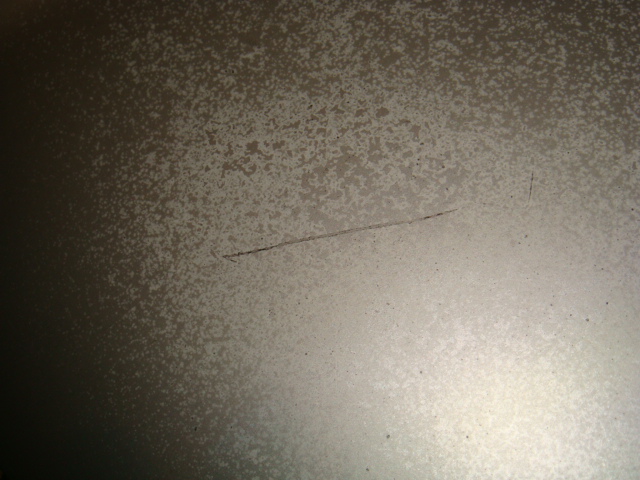

Clear coat peeling with a black paint tranference
attachment.php

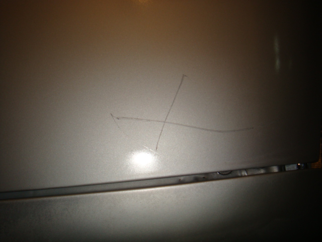

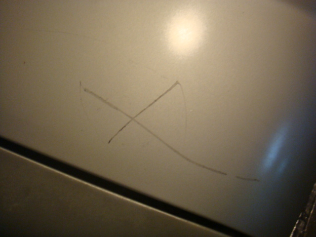

A mysterious deep cross scratch. Done by an angel? No... Angel of death I believe.
attachment.php

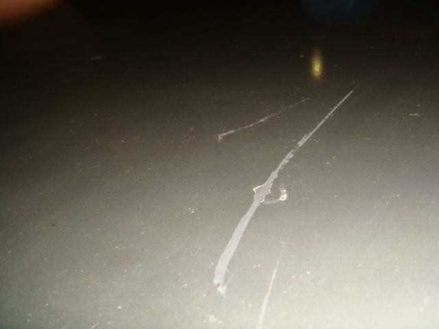

Scratch till the paint is gone
attachment.php

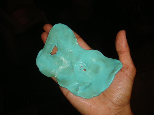

Started with ONR. I always love the smell of ONR like bubble gum! Just 1oz into 8 L provides plenty lubrication and the dirt glides off effortlessly...
attachment.php
Not so dirty actually... Accidentally clayed on a panel that I haven't washed :biggrin:

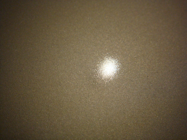

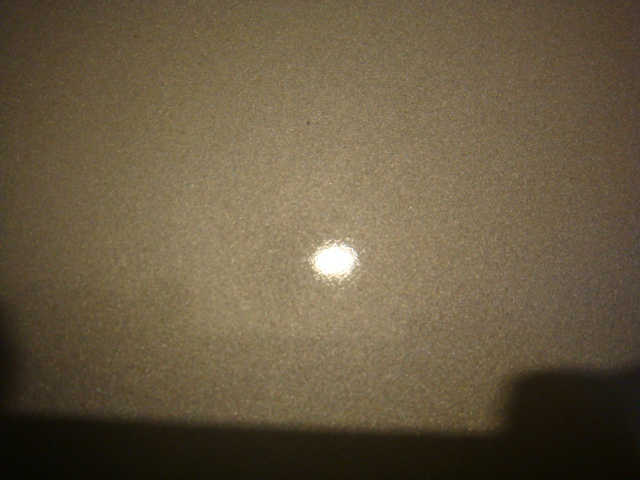

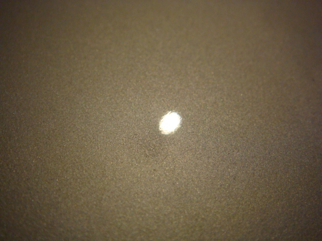

So coarse and blurr...
attachment.php
I can't even see the proper shape of my light bulb...

I just can't help but b attracted to this cross and wonder what caused it?

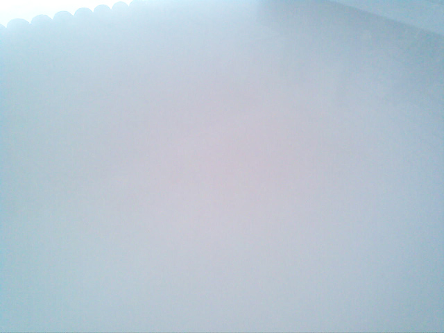

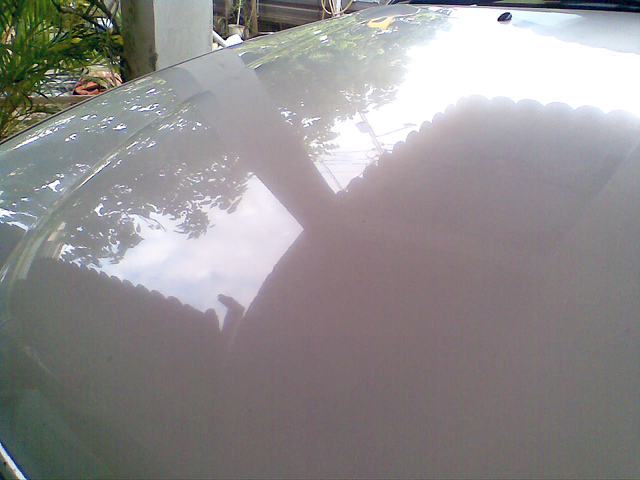

This is after compounding by Optimum wool pad + Optimum Hyper Compound. First round only... Didn't snap the second round. Gloss restored but still not there yet. Need the mirror effect!
attachment.php
attachment.php

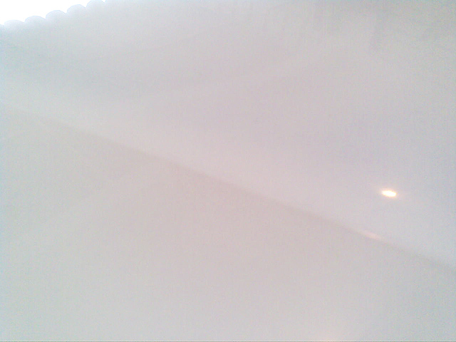

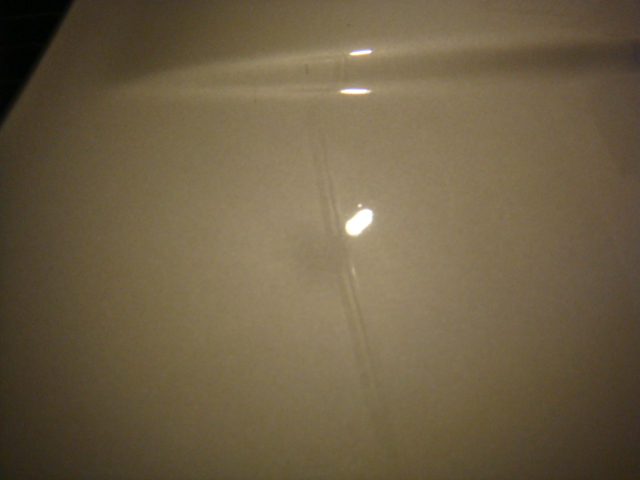

After polishing and refine with Optimum polishing pad with Optimum Hyper polish... Okay! At last can see the bulb on my ceiling!
attachment.php
No halogen yet... Try to spot come marrings with flashing all over the bonnet... Okay lah!
attachment.php
Only did the bonnet because of time constraint. I started 8 at night when my hands felt itchy... Didn't get to do the rest... Next day, I sent it for paint.
Shaved off some paint as the clear coat was gone in many places already... Thanks to OPC, cleaning the wool was a breeze. I took time learning how to use this product. But once got use to it, it really is quite convenient! Clean engine, tough stains, paint, interior, and pads...
