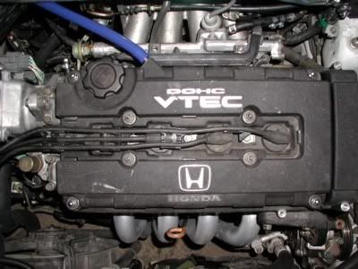

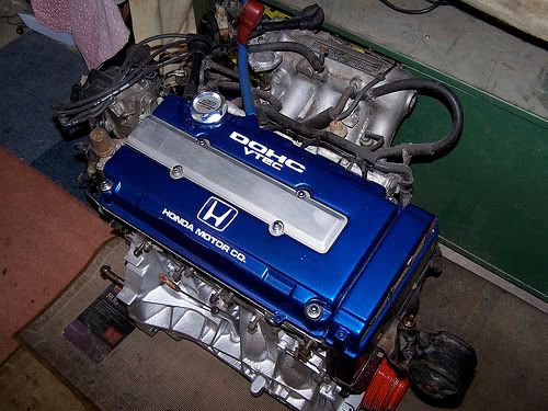

Can u tell me the diff in this 3 pic??
if u can answer it right,then go ahead with EG6,
if not, u might wanna booking for EXORA then..hehehehe

errr... ummmm.
for the 2nd pic black cam cover with big VTEC alphabet
so its a b16a BIG Vtec?
and for the 3rd pic with red cam cover its a TYPE R engine
so its rather is a b16b or b18c am i right? yay i guess im right?
so what about the 1st picture?
blue? custom? lol?
blue? custom? lol?

for 2nd and 3rd pic u r right,
but how bout d 1st pic?
can u spot the diff?
blue coverhead summo!!hehehe
