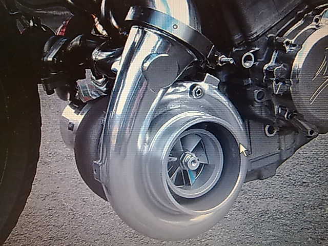

Drag Hayabusa Xtreme Boost
Par Billet Rod
Forged Pistons
Billet Crank
4pc 1200cc Injectors
Weldom 1000hp Fuel Pump
Bullseye Turbo
Twin TIAL Wastegate
Haltech Platinum 1000
Rated 600WHP
Everything Can Be Tune with HALTECH

The turbo isn't a Bullseye.... it's a GARRETT GT42R.

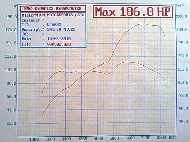

Mivec GTI 1.8 Upgrade
1.Intake Manifold Type R
2.Pistons High Comp.
3.Cam Pulley
4.Little bit Inject Ethanol end Tuning.
5.Haltech Platinum 1000
Tuning fueling and little bit Timing adjustment the Engine get 180whp(Shell V power)
and 186whp 140ftlb Torque(Inject Ethanol E85)

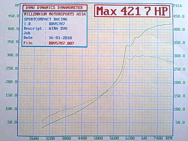

Street Wira Evo
1.Microtech LT10s
2.Cam 272
3.Cam Pulley
4.GT30
5.Injectors 1000cc
421.7whp,Boost 1.6bar and 300ftlb Torque and more timing
Enjoyyyyy.........

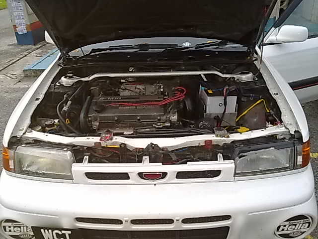

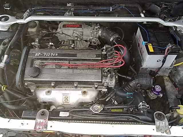

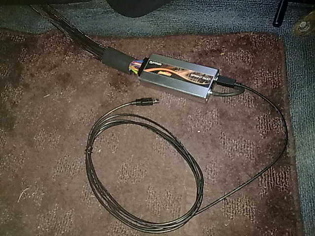

Again Mazda B8 210 stock gaban engine lantai kedai potong.
Running 0.9boost 268whp and 230 torque.
Turbo 210 internal wastegate.(no boost controller)
Running Haltech sprint 500
Next upgrade
Turbo Bullseye advice
Turbo manifold
Wastegate 38mm
Injectors 850cc
Intercooler piping
300whp club coming soon
