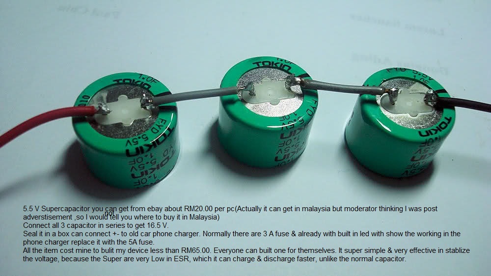

And everyone can DIY one with super powerfull 3 million uf VSD. with less than RM100.
*Major reason why I plug the DIY VSD inside my car rather than do it the traditional way is because normally super-capacitor have max operating temperature of 70 Celsius degree. So it not suitable to install in the car engine chamber which was hot. If you want to do install in the engine chamber also can but must be in front of car radiator or in car bumper away from heat source and water proof it with epoxy seal . You were amazed by the led light on for very very long time when you unplug it from the 12v source.

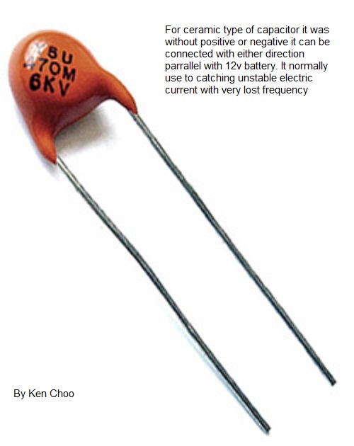

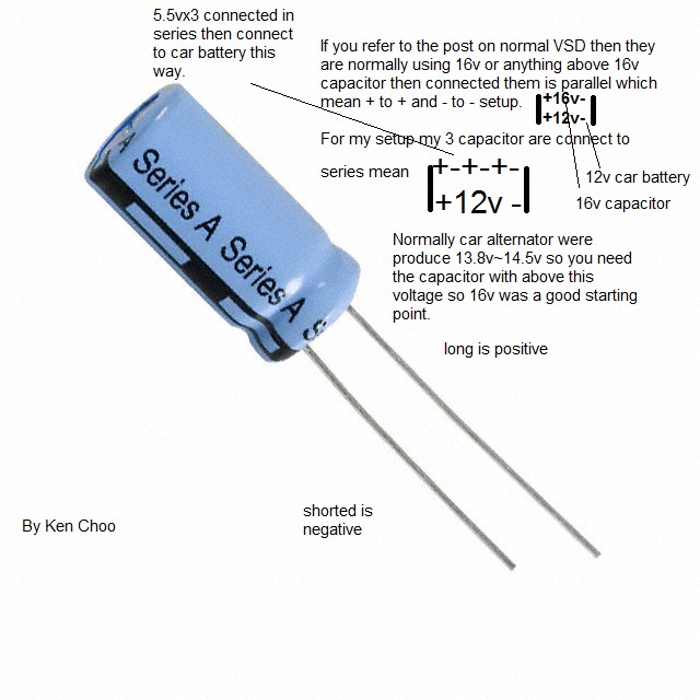

hmmm...for the capasitor is it have +ve & -ve terminal?....in order to connect it just soldering one +ve capasitor to other -ve capasitor ya? sorry for silly question that i ask....after read almost 70++ page a bit confusing how to do it...hehe
My VSD is different with other
If you do it traditional like other using normal 16 v capacitor you only need to connect them in parallel like in the picture. Do use some small uf ceramic cap to filter unstable current in low frequency.
If you want to do it like what i did then connect 5.5v capacitor in series to become one 16.5v capacitor then connect the +- parallel to the car battery.
