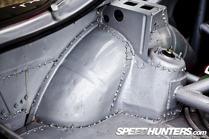

if dong full car spot weld will be much more stiffer than oem chassis, that one is race preparation for race dy
But do you think if lets say someone do a full spot weld on a Wira 1.5 or maybe Wira 1.8 C99 chassis, can they achieve the kind of stiffness in your CD9A? I don't think so after seeing your photos of areas with reinforced welds in Evo.

Much more stiffer, mean for race use

ek9's, dc2's most type R's are the same as evos, they have some additional welds here and there.... errrr iirc rear towers and backside section are reinforced, duno whats diferent up front.
Even after spot welding, will the chassis be strong enough? I remember one of your old quotes about a Putra with chassis cracks.
Your quote back then.
Yes. But key word is "regularly went track". If you're planning to go track regularly - then I'd probably do more than spot welding. If it's just a daily drive, cracking a C99 chassis is going to be a tough affair.
I see. So it is actually possible to further reinforce a weaker chassis with this race use method.
The Type R variants are definitely having reinforced chassis. But how about those one step below Type R models? The Civic SiR chassis? Or the Integra SiR?
So, that is the key point then. If one does not go to track often, a C99 chassis will be strong enough even for powerful engine swaps.
