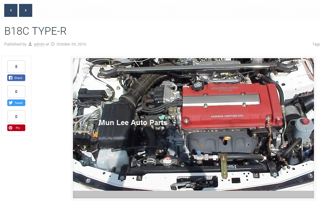

found this half cut, looks like the long one is from dc2, answer my own question... haha
