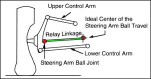

i dunno whether these pics correct or not bout the balljoint..i'll post my car pics once everything is done ok..:driver:
