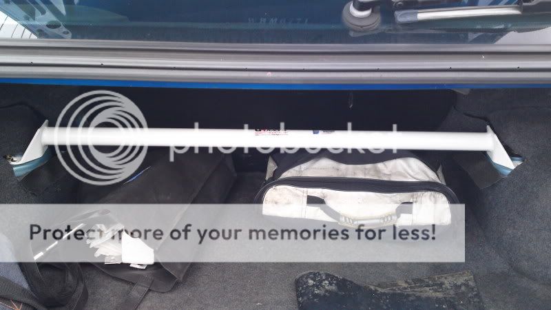

i bought front e4 bars and yes, its fit nicely. then i bought rear e4 strut bar and NO, it wont fit. Try to modify but sadly cant use anymore (i dont have skill to modify, maybe).
So, can somebody really confirm that e4-e6 rear strut bar can fit to ck2a or maybe i been given wrong strut bar!!:bawling:
@cikaro - i'm not so sure about the rear one, the size seems to be ok but the problem is getting it to fit in right? one end can go in but the other end can't because the thread from the absorber is blocking right?
My friend told me to bring it to a machine shop to get it engineered, but I haven't done that yet because I don't want to cut the carpet lol.
@ kairigi,
its really difficult to modify rear stut bar. if send to engineering maybe can lah. but today i already found the solution. rear strut bar for lancer mx ck2a is same as wira. absolutely no modification needed. there u go:
patt no: UR-RE2-059
and offcourse, u need to cut ur carpet:hmpf:
