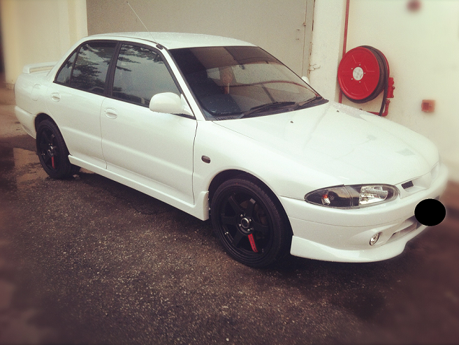

I'm new here, sorry if posted on the wrong section.
I need some advice on fitting adjustable on my car, Budget is around RM1200 including adjusting and fitting (Preferable cheaper, avoiding eating maggie for the rest of the month :s:) . Saw a few brands out there suitable with my budget but don't know which to fit. Brands like Titan, GAB, Tanabe, HWL, Zerone. (Recommend to me if theres other brands out there which is good)
I'm looking for Hi/Low only. Purpose > Lowered, better stability and handling. Wanted to lower till 1 finger left between tyres and fender, or more than that. (Poison by stance, flush :biggrin:)
I'm driving a Wira 1.6 on 17" wheels and tyre profile 205/40.
Currently Tanabe Sustec with 6k front, 4k rear catches my eye with fully serviceable and 1 year part to part waranty.
So, guys.. Please help/advise me on which brand to choose so i wont regret after fitting it.:stupid:
Thanks in advance.
